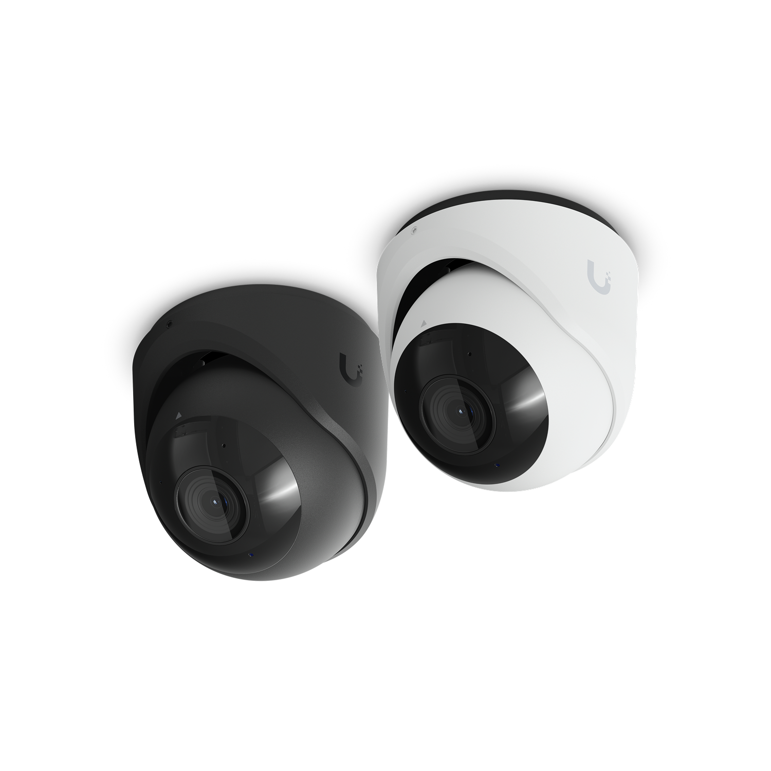

For people like me that don't have the time to fiddle with things and need them to work for years on end and with remote management and remote firmware updates that work out of the box... it seems like UNIFI protect is the way to go. Yes, my Dahua Turret (Dahua-5231ZE) has a handsome look and I like the large glass on the front and this looks better to me than the UNIFI cams, I hate the G6 Turret (Eye Ball Look). But I like the software end ecosystem and that they are rapidly improving. I bought a Dahua NVR and was not impressed with anything about it. It was seemingly like something out the early 90s... The hardware was super basic and rudimentary and the software was worse, there was nothing polished or impressive about it.

UNIFI 4K 8MPa 1/1.8" Turret Smart AI (Multi-TOPS AI Engine) Camera, UVC-G6-Turret-W sells for $199
So the G6 camera is $41 cheaper and has: Face Recognition, License Plate Recognition, Smart Detections (People, Vehicles, Animals). Has Quad-core Arm® Cortex®-A53 based chip that does the AI on the camera. And, the software (UNIFI Protect) seems much more powerful and polished and user-friendly and where the product line is constantly improving.
Am I missing something? It seems like UNIFI is on fire right now and the value is undeniable even with a technical user like myself with a career in software development. Sometimes you want things to just work.

I don't know if you're overall right or not, but you do have a good list of arguments. Pitchforks not needed for valid questions and discussions. The obvious thing that will be pointed out is for the sensor size, a 4MP sensor is probably a better choice.
Something you have to ask yourself.. Why don't they say what F/Stop that camera is using? My guess is a f/2.0 and with as stated before the sensor is great for 4mp and sure I have some 4k cameras with that sensor and worse even but with better f/stop and so low light is ok not great.. Then one has to wonder why would that camera with same options and features as the Ai Turret be 1/2 the cost? I mean a speaker and white LED and ugly blue ring don't make a camera cost 200 more? Something don't add up.
Have some Dahua cameras that are 4k and that sensor. F/1.0 but as stated before my 4mp same sensor and lens has better low light and less noise at night..
