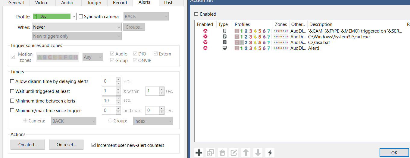

OK, so now I am having similar issue, where it worked fine previously. .I am getting pushover alert on phone every 2 minutes or so. Same alert, same jpg, just resent over and over. Alert is priority 1, not 2, in the curl setup.
I checked Trigger/immediate actions: blank.
On the alerts tab, for now I have When: Never, and "On Alert" / action set is NOT enabled and each alert I have listed is "NOT enabled".
Each camera is set to sync with camera 1 and that is where I have set this up.. .so no spurious settings in other cameras: They mirror cam1.
Yet I am still getting these alerts sent to Pushover even with all that disabled.
If I shut down Blue Iris (and shut the pc down), the Pushover alerts stop, so they aren't being generated by Pushover server or phone.
rdxny
Oct 15, 2022
142
86
ny
well, I didn't find the cause, but I deleted the main camera that the others copied the alert settings from, and manually re-added all the settings, and it is now working as expected. That's good, though it bugs me to not figure out what was causing the constant triggers! But all good now.
