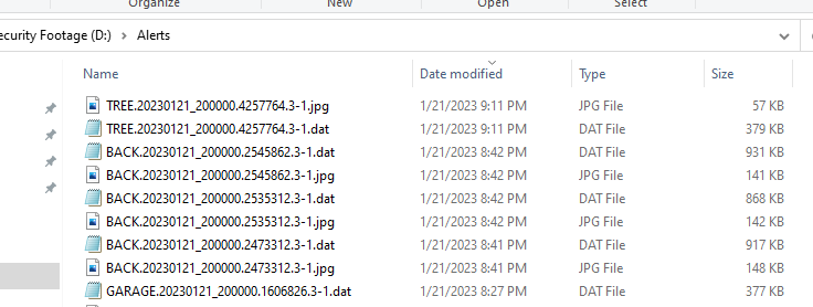

I did try them.. since just removing the attachments part at the end allows Pushover to send the alerts, I assume everything BUT the attachment image part is ok.
the syntax I'm using is -s --form-string "token=TOKEN" --form-string "user=USER" --form-string "message=<b>&CAM</b> &MEMO <a href='&WAN/alerts/&ALERT_DB?fulljpeg'>Hi-Res</a> <a href='&WAN/ui3.htm?rec=&ALERT_DB'>UI3</a>" --form-string "html=1" --form-string "device=YOUR_PUSHOVER_DEVICE_NAME(S)_HERE" --form-string "sound=YOUR_PUSHOVER_SOUND_HERE" -F "attachment=@D:\Alerts\&ALERT_PATH"
testing it to a txt file gives:
-s --form-string "token=TOKEN" --form-string "user=USER" --form-string "message=<b>FRONT</b> <a href=''>Hi-Res</a> <a href=''>UI3</a>" --form-string "html=1" --form-string "device=YOUR_PUSHOVER_DEVICE_NAME(S)_HERE" --form-string "sound=YOUR_PUSHOVER_SOUND_HERE" -F "attachment=@D:\Alerts\fnf"
Screenshot 2023-01-21 213544.png the jpgs are in the d:\Alerts folder. I just can't see the issue.

well, I tested the same string today.
I was testing last night using the "test" button in the alerts action set. I could get Pushover to work WITHOUT the alerts attachments part at the end, but not with it.
BUT, I tried triggering the cameras myself today (rather than use the TEST button) , and it now works WITH the attachments string, and sends the jpg image. I have no idea why, but that's the way it is working here.
