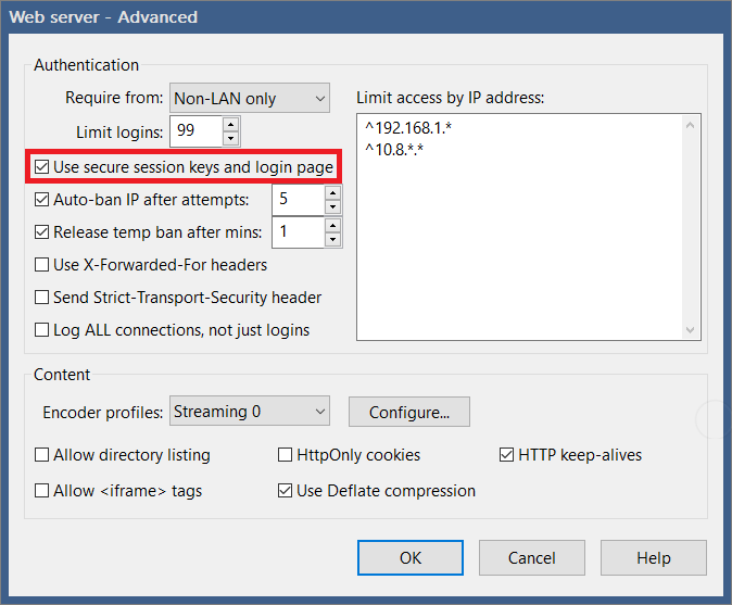

Could you clarify one detail related to the new (optional) posting to the BI logfile feature?
Is it mandatory to set this (...to use credentials, be sure to uncheck 'Use secure session keys and login page' in Blue Iris settings: click Settings > Web server > Advanced)
to the unchecked/insecure setting in BI if we choose to set the next setting (OPT-IN TO USE CREDENTIALS FOR POSTING TO BLUE IRIS LOGFILE) to false?
It would seem unnecessary, but I don't fully follow the logic here, as your help comments in the README/script seem slightly misaligned with regards to what section they apply to.

I just installed and set this up. It's working, but I can't seem to get the BI logging to inject anything into the logs. Here's how I have it set. I made a new Admin user and put those credentials in the config, and made sure use secure session is off. I can login to ui3 with that un/pw using 127.0.0.1:81 from a browser on my BI machine.
Code:
# OPT-IN TO POST CUSTOM MESSAGE TO BLUE IRIS LOG
# ... expecting $false or $true (default = $false)
#$post_to_BI_logfile_flg = $false
$post_to_BI_logfile_flg = $true
    # THE FOLLOWING ARE [REQUIRED] IF OPTING IN...
    # ENTER BLUE WEBSERVER ADDRESS & PORT
    # ... to use credentials, be sure to uncheck 'Use secure session keys and login page'
    #     in Blue Iris settings: click Settings > Web server > Advanced
    $bi_webserver = "127.0.0.1:81"
    # OPT-IN TO USE CREDENTIALS FOR POSTING TO BLUE IRIS LOGFILE
    #$post_w_creds_flg = $false
    $post_w_creds_flg = $true
    # [OPTIONAL] ENTER BLUE IRIS WEBSERVER USERNAME & PASSWORD
    # ... NOTE: USERNAME MUST BE ADMIN
    $bi_user_name = "XXX"
    $bi_user_pw = "XXX"
    # OPT IN TO LOGGING ALL EVENTS (NOT JUST ERRORS)
    # ... [boolean]
    # ... Default is $FALSE
    #$post_all_events = $false
    $post_all_events = $true

EDIT #2: Never mind. While answering @jrbeddow 's question below I spotted a bug. I'll post a new *.zip file soon.
Sorry it's not working.
The log entries should look like this:
1. Status > Messages log ... (Note: the 'Message' entries get truncated by Blue Iris; you must inspect the *.txt logfile.txt for the full entry)
2. Via the *.txt logfile (complete versions of the same entries highlighted above, but in reverser order)
Are you sure the user is an administrator? Like this...
The script uses the following HTTP Interface command. Try using it directly from your browser using the same credentials in the configuration *.ps1 file.
Sorry for being unclear.
All settings/requirements below the $post_to_BI_logfile_flg = line are moot if the line is $post_to_BI_logfile_flg = $false
I've attempted to signal this by indenting the code under this line. For clarity, I'll edit the comments to make this more explicit in the next version.
By the way, here's the code that uses the above mentioned settings. Maybe this will clarify the logic.
Code:
    # Remove incompatible substrings from $MsgStr
    $MsgStr = $MsgStr -Replace "`n", "" -Replace "\\r", "" -Replace "\\n", ""
    $bi_address = $script:bi_webserver
    if ($script:post_w_creds_flg) {
        $uri = "http://$bi_address/admin?log=$MsgStr&level=$Level&user=$script:bi_user_name&pw=$script:bi_user_pw"
    } else {
        $uri = "http://$bi_address/admin?log=$MsgStr&level=$Level"
    $result = Invoke-WebRequest -Uri $uri
Does this to address your question?

I'm not sure that I asked the question clearly: is it a must to disable the secure webserver option when enabling the BI Pushover logging function (in all cases)?
