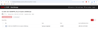

Hello David L! Thank-you for your brilliant suggestion. TLDR: The result is "HOW TO INSTALL FIRMWARE ON EZVIZ DB1 (POSSIBLY EVEN IF IT IS BRICKED) USING ONLY THE SD CARD"
So I did what you suggested, and got this very nice letter back the next day:
Hi,
Thank you for reaching out to EZVIZ!
Regarding the issue you have encountered, please try to update the firmware and see whether this might help. To upgrade firmware, you will need to prepare an empty SD card, an SD card reader and a PC.
1. First please insert the SD card into the SD card reader and connect the reader to your computer.
2. Log in your email box on your computer, visit https://drive.ticklink.com/hcs/controller/hik-manage/fileDownload?link=7voiSloE& (password: 625z) to download the firmware package and save it in your SD card (When saving, please change the file name to "ezviz.dav").
3. Power off your EZVIZ device, take out the SD card from the reader and insert it back to the camera.
4. Power up device again, and then wait for 3min it will complete the update process automatically.
(If the SD card remains in the device, kindly take it out and ensure to delete the firmware before reinstalling it. Please be aware that upon successful firmware upgrade, the firmware will be automatically removed from the SD card.)
If you have more questions or require further assistance, please let us know. We would love to help.
Have a nice day!
Best regards,
Alesandra
EZVIZ Tech Team
Regrettably, the 'issue' that I wrote in to them about is that the SD card socket on my DB1 appears to be dead. I tried 4 cards (2x128GB (exFAT) 1x32GB (FAT32) 1x2GB and none of them are recognized. These cards are all recognized in other cameras, and I can write to them and format them and read from them.
Whelp, looks like I'm gonna have to pull them darn DB1 security screws out again and give it a shot. (SD Card based firmware upgrade - I doubt it will work on my DB1 however I will then try with Batch Config Tool) I suspect I may need a warranty replacement DB1 which is sad because DB1 no longer in production and none of the successors run ONVIF. Dang. On the plus side, I can try to duplicate pete_c's test outcome with creating new users on DB1 firmware 200321.dav
Anyways, in the meantime, we now have a .dav file of the latest and greatest EZVIZ DB1 Firmware (that does NOT support ONVIF) which was what I originally asked you for - Yay! :)
By the way, this is the exact same version that the EZVIZ phone App asks you to update to if you let it.
As you predicted, HikVision and EZVIZ are one and the same. The file download site sent to me by EZVIZ support cinches the deal. (Attached photo)
Perhaps you should add a sticky to the 101 post that points to this post in case someone needs this version of DB1 firmware, or needs to unbrick their DB1.

I do not add the user under the ONVIF configuration. I add it under the system user section.
Thanks pete_c. That worked on F/W 211101. Photos attached.
