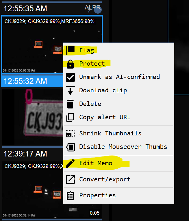

2. Correct plate can correct the memo in blue iris also
3. Protecting a plate could protect the clip in blue iris also
UI3 has these, you can check UI3 repo on how he is doing it.
I think I understand from the docs. It’s fairly straightforward.
The meaning of “flag” is kind of different in the ALPR database vs blue Iris, so idk if I would do that one.
Right now literally all it does is put them in a list and turn it red. Kind of a do-nothing remnant from the original release, but maybe will become useful with automation flows/rules or any db sharing. I might change the name of it to something different. My original intent was for it to be a list of vehicles that you know are problematic.
