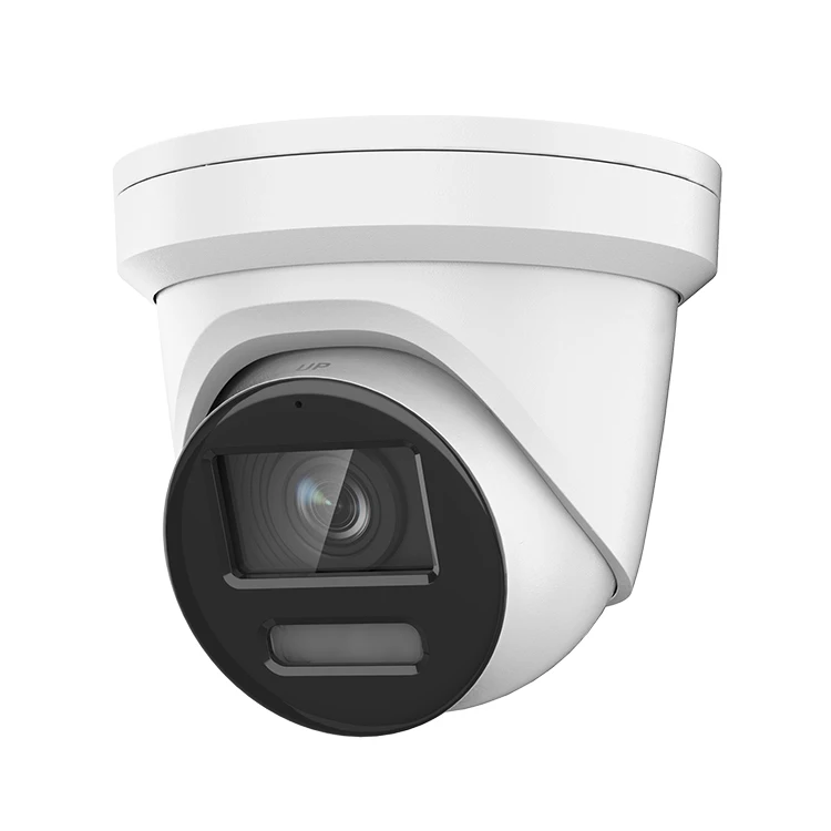

I am looking to get three new cameras for the front of our home
I bought some cheap variants of 8MP ColurVU cameras and was impressed by how well the colour is at night (the street lights help them) but i want some better quality and want some of the smart detection which these lack
These were it- ColorVu 8MP 4K Hikvision Compatible Security IP Camera Full Color POE outdoor US | eBay
My NVR is a large synology NAS and i have enough licenses and plenty of storage available.
I am looking at
  • 8MP / 4K
  • ColorVU
  • Smart Detection abilities, AI tech etc etc
The only ones i can find that appear to be decent are
  • Hikvision DS-2CD2387G2-LU 8MP ColorVU(Most Expensive ~ $400aud ea)
  • Dahua IPC-HDW3849H-AS-PV 8MP (Mid Cost, $250 aud ea)
  • Reolink 4K 8MP Ultra HD, Person/Vehicle Detection. Color Night Vision RLC-824A (Cheapest $110 aud ea)
Thank you

Have you considered the 4K/X sold by @EMPIRETECANDY here. He sells to Australia as well and many members are here from Australia and can vouch for his pricing and service?
The 4K/X is the most popular 1/1.2" camera and doesn't seem to get as many complaints about quality at night as the other "full color" type cameras.
Do a search here. Many have not been impressed with the Hikvision DS-2CD2387G2-LU. Keep in mind that any camera called "full color" or "night color", etc. still require light. They are not magic and do not defy physics. Many people have come here after buying the Hikvision ColorVu series expressing their disappointment in the picture quality of the camera because they were expecting magic. If you do not have ambient light outside, you are better off with cameras that can see infrared. Further, it's onboard white LED lights are not as bright as the 4K/X. There seems to be more complaints about the Hik version at night than the 4K/X.
Stay away from the Dahua IPC-HDW3849H-AS-PV 8MP. This active deterrence camera is an 8MP on a 1/2.8" sensor, so it is on a horrible MP/sensor ratio. You cannot have enough light at night for it to perform well.
Even worse, this 8MP is on the same sensor and CPU as a 2MP non TIOC camera and there are many threads here showing how under-performing that 3849 is. They had to limit bitrate and other parameters on the 3849 to try to make it functional, and it just doesn't cut it.
In my opinion the 3849 should not be sold with that current MP/sensor and CPU combination, but alas everybody wants 4k and chases MP over sensor and this camera is the epitome of that thinking.
Further, the red/blue flashing lights are more gimmicky and are certainly not a deterrent. With any ambient light you won't see the red/blue flashing unless you are looking right at the camera.
If you want active deterrence, your best bet is to go with the 2MP IPC-T5241H-AS-PV that will blink the white light. This is on the ideal MP/sensor ratio and will perform comparably to any similar 2MP fixed lens camera by Dahua. I have two of them. I have some of the other active deterrence cams as well, and would opt for the 2MP in every instance except for indoor, one could go with the IPC-HDW3449HP-AS-PV that has the red/blue lights that will bounce off the walls and be much more impressive than outside.

I really like this one. I have purchased some from Andy when he had them in stock. He may still have some.
DS-2CD2087G2-L(U) | Pro Series (All) | Hikvision
The key specifications.
  • Image Sensor1/1.2" Progressive Scan CMOS
  • Max. Resolution3840 × 2160
  • Min. IlluminationColor: 0.0005 Lux @ (F1.0, AGC ON), 0 Lux with Light
I've got two of these, both 4mm. One off an AliExpress store about 6mths ago, it came with the bottom of the box unsealed and had some focus issues. It wasn't from Empiretecandy. I recently adjusted the focus myself and its a lot better I just bought the second one from @EMPIRETECANDY and it's perfect.
As you've got some experience with cheap full colour cams already, I doubt you'll be disappointed. You will also have some idea about light requirements- you do need some. The human and vehicle alerts are amazing (after being annoyed for years by the wind, rain, trees, shadows etc causing false motion alerts.) It will detect even the most distant people- like three houses away on the street. Even in low light.
I'm in Australia too and would recommend sending Andy a message for prices. Delivery is quick as he uses express carriers.

The specs say they both have the 1/1.2" sensor and the same 0.0005 lumen rating.
PS: the "depth of field" ( minimum focus distance) on the 2087 is really bad -
  • Depth of Field
    2.8 mm: 4.5 m to ∞
    4 mm: 7 m to ∞
    6 mm: 13 m to ∞
compared to the 2387 -
