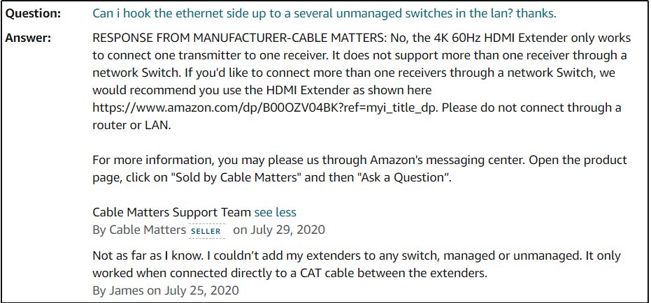

IMO, I do not think that meets the goal of the OP. In amazon's Q & A's for your linked device it states those only connect transmitter to receiver and are not networkable. It also provides a link to another pair of devices that is one-input-to-many-output, but it can be done only with it's own dedicated switch and not part of a LAN.
I did link a different set, which I thought was the 4k equivalent version, but did not inspect closely enough.
I have used these exact set on my network: Product page: HDMI Over Cat6 Extender
I have roughly 40 of these on a network with other ip cameras. (Transmitters only, feeding into Blue Iris)
I have a few more at a medium sized office, around 150 workstations. They are not on a segregated vlan, but it may be best practice to do so. One transmitter, 4 receivers, used as an announcement board.
The only issue I have is that compared to a dedicated HDMI encoder, there is very little you can modify. They still do output a main and sub stream, allow changing the resolution/bitrate of each, and you can input a static ip. No framerate adjustment however (30 fps). Still, for $80 for a transmitter, receiver, and a pair of HDMI cables they are much cheaper than almost any HDMI encoder on the market, and pretty flexible with the receiver.
I have quite a few spare receivers now since I have mostly used them to transmit the RTSP streams to Blue Iris. They seem to be out of stock at the moment, but there are equivalent units available as Cable Matters has just slapped their brand on these things coming out of China. (e.g. Monoprice 1 , Monoprice 2) I actually have a single one of the 1st Monoprice units, which is identical to the Cable Matters in function. (and firmware) The Monoprice unit can be split and just a bunch of receivers purchased to fill out a system more cheaply though. receiver
