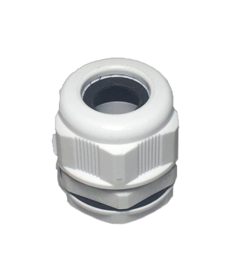

However, I would like to use pvc conduit to protect the network cable.
Not sure how to do that with this mount. I will probably still need the junction box (but not the round Dahua box) to sit underneath.
/edit/
I just start with a junction box. And connect it to the pvc pipe using a joint like in the picture:
Should I still feel the need to use a wall mount I could replace the round junction box with a regular square ip666 junction box from the local DIY:
