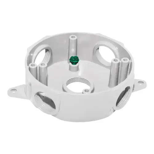

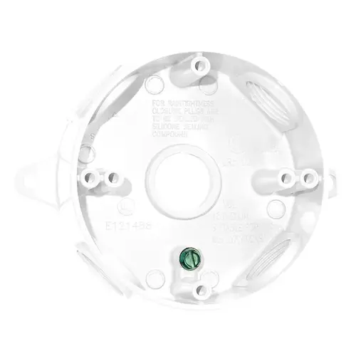

Thanks for the quick response. Given there's no good soffit mount light/camera combo and I can't do motion only light on the IPC-Color4K-T, I'm going to have to use the existing electrical wiring.
I believe I can purchase something like and just mount it right to the soffit (has a wood backing). This atleast gives me a box to put the electrical wiring in so it should be much safer than how they had it before.

I ended up just using a surface mount box and pulling my electrical wire back into it. Since I really only needed a floodlight I just went with a Eufycam Floodlight with Wifi in this situation.
