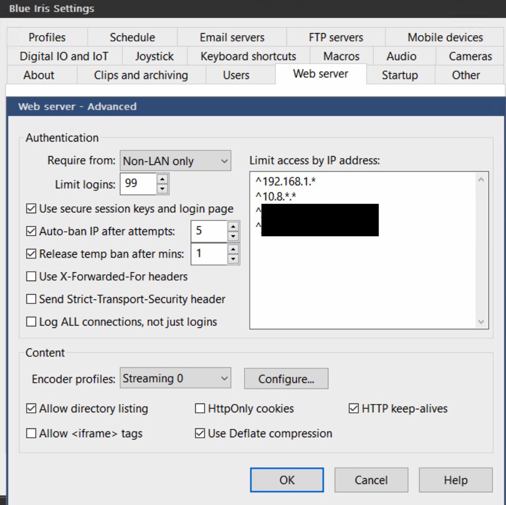

Glad to hear you've got it figured out.
I've always disabled the anonymous user, assigned named users, and used settings like those in the screenshot below.
The only reason I allow anonymous access when on LAN is so when a tablet or device like a TV connects to the BI server it'll automatically login without asking for any credentials. I try to keep it simple to login because I'm not the only one who views the cameras.

Gotcha...
Just curious.. Advanced setting 'Authentication Required from: Non-LAN only' does not do this for you?
That's how I have it set up. Once you enable Authentication from Non-Lan only it automatically creates an anonymous account in users. Anytime a device on the local network connects to a BI stream it uses the anonymous account and whatever settings are associated with that account.
D'oh! I've just read through the relevant sections in the Help pdf have been re-educated. Thanks!
When I first started using Blue Iris I vaguely recall seeing activity in the log that I did not like (or understand). I then disabled the Anonymous user account and added my LAN address range (^192.168.1.*) to the' Limit access by IP address field... Until prompted today, I had never revisited this topic!
