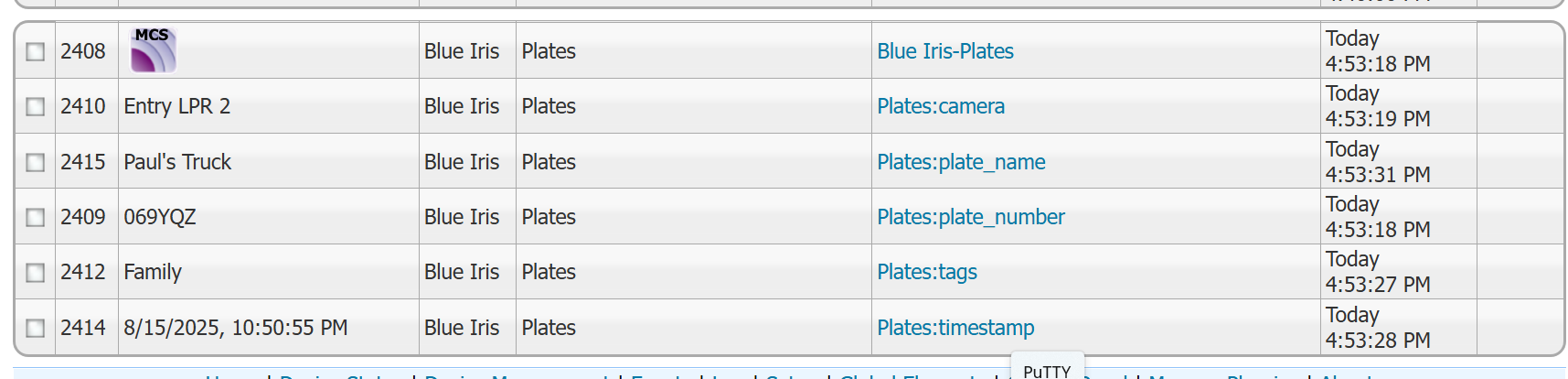

1) The payload should be sent like how Blue Iris sends things. For instance { "plate_number":"&PLATE", "Image":"&ALERT_JPEG", "camera":"&NAME", "timestamp":"&ALERT_TIME" } comes across as multiple payloads under one topic and sorts nicely on my home automation system. As it stands I cant tease out the data I want on the single payload.
This is now working great. I have each data point coming across as a sub topic
One point that was mentioned before: The time stamp is wrong.
