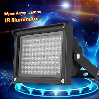

Hello Guys,
looking If there is a POE Splitter way to Power one of these 12v Outdoor IR Lamps:
How would you do it for a Cable Distance of up to 20 Meters?
Is this even possible with a Cat 6 Cable, Splitter and Poe Switch that can do 30watts per Port?
Any Expertise is Welcome! Looking to Power 6 of those Lamps!

Thanks. Got mixed replies now on Amazon from customers saying the opposite.. I Just want to make Sure the Idea works with the hardware and you actually can Power the IR LED Lamp using the PoE Switch and Splitter with Cat 6 Ethernet Cable.
Those Lamps are pretty common on the web and seem to be the Perfect Solution for Bugless Night Vision on Larger Areas arround the House.

Yup. Thats the Idea. Totally works with two IR Cameras where one has IR light disabled and just uses the light provided from the other one.
So this massive 96Led IR Lamp should provide a Blow away night Image for the cams arround it and solve any Bug flying issue.

You do need to be aware of the power capabilities of your PoE switch, both per port and total power available. That IR lamp is a 12 watt load. A typical camera uses up to 5 watts with the IR shut off so that is a total load of 17 watts, or so, to each port with a lamp on it.

The switch is a POE+ that can do 30watts per Port... That Part i checked. For the 6 Lamps either a own Switch and Ethernet cables bought together with the ones needed for the cams... or Just the 6 x 12v Power cables needed for the Lamps and Just the cables for cams.
Unsure what would be the proper Power cable on the Market for such a Lamp and prices for 20 Meters.

The adapter I showed you only outputs 15w maximum. That light you linked is 12w. The camera will eat up another ~3w more than likely. You are going to be close to max output for that adapter.
The issue is that 802.3af is really only designed to output 15w per port. You could get something like this: POE-SPLT-4812G-P-GigE Splitter,802.3at PoE to 12V 20W Out
That is designed to be fed either by 802.3af or 802.3at. But the problem is your camera isn't 802.3at is it? Its probably 802.3af I'm assuming. So your switch port negotiate back down to 802.3af since it doesn't sense a PoE+ device at the other end and you will still be limited to 15w max output power. You really should just make a new network cable run just for the light and this will avoid the entire issue.

Generally, the recommended cable is 23 gauge, solid copper, cable. Keep in mind that PoE supplies 48VDC that is regulated down to 12VDC by the camera or PoE splitter. That 48VDC supply cuts that actual current on the cable by a factor of four. So a nominal 12 watt load at 12VDC translates to about 250ma on the cable itself.
