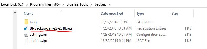

Have you manually clicked on the backup button?
Yes, I think that is the only way to do it.
BI Tools>Options>Backup>Backup Blue Iris Settings / Cameras>Export BI Settings / Cameras
BI Tools says that has been successfully backed up, but when I navigate to the default folder where it backed up the settings (C:\Program Files (x86)\Blue Iris Tools\backup) no new file exists. Also, I have almost 30 cameras and the backup procedure only lasts a few milliseconds which I know has to be wrong. It would take a couple seconds at least to backup all the Blue Iris settings and cameras.
I think alot of people using BI Tools run the backup and just assume that it has backed up the BI settings / cameras properly because of the "Back Up Successful!" verification window that pops up.
Go check your backup folder now and see if yours is backing up the Blue Iris settings and cameras.

You are correct....it says backed up, but when I look at file it isn't.
