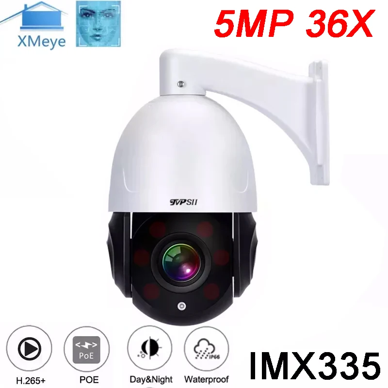

This is the camera, there are different options. I got the 8MP x30 Zoom
AU $227.86 40%OFF | Auto Tracking Face Detection 8MP 4K 5MP Sony415 H.265+ 50X 36X Zoom 360° Rotation Audio Outdoor ONVIF POE PTZ IP CCTV Camera

Spec only says 12VDC or 48V POE, so hard to tell how much amps or watts you need.

Still shots are meaningless. If you actually believe all the "specs" on that page I've got a nice bridge you can buy, six lanes in both directions and an automated toll both on one end.
5MP on a 1/2.8" sensor is useless at night, period, full stop, end of story. What is the shutter speed in your photos? 1/15, 1/20? Any motion will be a blur with a shutter speed any slower than 1/60, 16.66ms. That is the simple physics of the situation. It's interesting that they don't mention the Fstop of the lens which is critical, too, for good night performance. I also see it's WiFi, or at least it has an antenna stuck on it. Another sign of high quality for sure. I see it has a built in mic. How's the pan/tilt/zoom motors sound? Bet they sound nice on the audio channel.
You're overly concerned with megapixels and not concerned with quality when motion happens. The 49225 may be only 2MP, but it will easily outperform that camera and produce blur free video of motion in the dark, which that 5MP camera simply cannot do.
