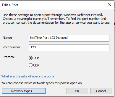

Thanks for the Windows Defender info. I turned the firewall off for private networks and the cameras are updating their time.
Now, I will turn the firewall back on and drill down to allow the cameras in.

FWIW, there is a good chance the router that is controlling the network has the ability to enable an NTP server already built in to the stock firmware. It's a common feature on routers for the last 15years or so. The big advantage of router based NTP is it is always available; in this case it also eliminates having to add holes to windows firewall as well.
