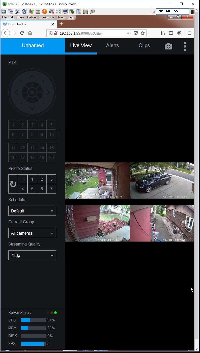

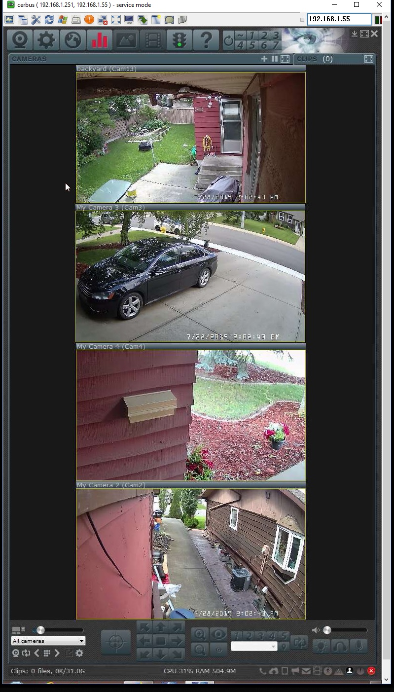

HI, apologies about my inexperience.
Screenshot of console interface :
screenshot of browser webpage
Maybe I'm doing something really dumb but I would like to access the BI4 computer remotely on a computer with the portrait monitor.

Thank -you!
that seemed to do the trick.
