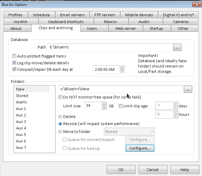

I find no place for alert retention, maybe I flunk "following directions 101". See screen shot.

I find no place for alert retention, maybe I flunk "following directions 101". See screen shot.View attachment 39465
Ensure you dont have smart codec or 264+/5+ selected in the camera video settings.
Yes you have flunked the course. You need to click on the alerts folder in that screen shot.
Blue iris uses time, pixel area and contrast for motion detection. If not setup properly as in your case it is easy for the same person to cause trigger/no trigger variations.
Thanks, will do. I also see an update for the web server that may fix my freeze problem. Probably wait until I go on site, 50 miles away. The system does not have Internet access. I need to renew the BI support as well.
Did better 15th time around. Now unchecked.
Edit: Thank you very much.
