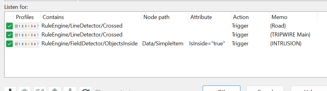

I created another rule for that cam as below: (with "road being the added rule I dont want alerts on)
Then set BI Onvif
But where do I tell BI to listen only to Road or Main? and where do I setup the alerts for one or the other, not all (they both "Trigger", and Triggers mean Alert also or not , but individually??

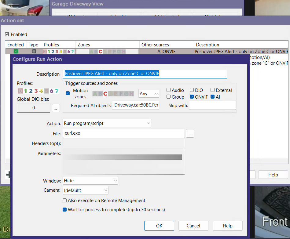

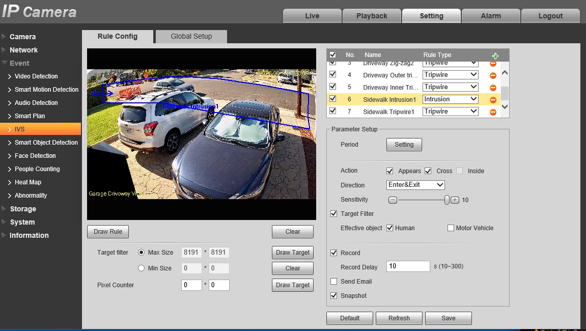

Half of this setup needs to be done in the camera GUI: you need to first create names for the IVS rules "in-camera". In my case, they start with the word "Sidewalk" for zones that I want the camera to record on (officially, these still technically result in an "Alert" in BI terms, which is what I want, but here you could chose to Ignore, or Trigger, or consider it an Confirmed Alert in the ONVIF Events box), but I don't need an Action Set notification for these (ie: a push/Pushover), so I don't add the word Sidewalk in the "Required AI objects" in the push/Pushover Action Set run action. Conversely, for any named IVS zone called "Driveway" (closer to the house), I DO add the word Driveway to the Required AI Objects in the Action Set run action.

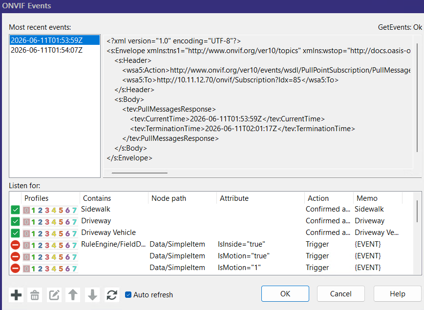

Best to illustrate:

1) Configure your IVS rules in the camera GUI, and be sure to re-name them to something useful and recognizable (DO NOT use "Tripwire1", "Tripwire2", "IntrusionBox1", etc....).
2) In BlueIris, go to the camera's properties Motion/Trigger tab, then use the checkbox for ONVIF/camera events (checked), then under Configure, you can turn OFF (disable) all the existing (difficult to decipher) triggers. Now start adding back (the + symbol in lower left) new event/triggers as needed: in the "Contains" box, add the name of each IVS rule that you used (one per rule here), the default action is "Trigger" but you can also set this to other things like "Confirmed Alert", and (very important) in the Memo/label box make sure to also match the name here to the "Contains" name (aka: the IVS rule name).
3) Now, go to the Alerts tab: Open the "On alert" button. Open the rule that you may already be using to send a push/Pushover alert notification: here, add the same name that you used above in Memo/label to the "Required AI objects" box for the Alerts that you DO want to receive notifications for (but obviously leave out those that you don't need notifications for).

EDIT: Note in my first image that you can have several IVS rules of each "category", as long as they are named consistently starting with the appropriate names for the important vs. unimportant regions. See how I have several that start with "Driveway" and a couple that start with "Sidewalk".
Thanks:) I had the first two parts down ok, but I couldn't see a way to differentiate the two IVS rules in the Alert tab, I was missing #3, the "required AI objects" part, thinking that was only for the built-in BI AI or other external AI. That's the missing part that should allow me to separate the IVS rules. Perfect! (I mentioned NVR because the camera GUI you show is way different than my GUI, I guess older or different camera or firmware? I just assumed it was the NVR version...just different:) ) Again, thanks for the detailed help!
No problem, and I agree that the solution is less than obvious. The key is knowing that every Alert has one or more associated labels (aka: Memos in BI terms), and that you can "manually" manipulate those Memos in this manner and control what takes place with them in the Alert, Action set dialog via the "Required AI objects" box.

Hmm...I haven't tried this, as I rarely use the filters for Alerts, but it could work. In the ONVIF details/classifications continue to setup the "outer" (less important) events as "Triggers" (the default), but in the same dialog reclassify the more important (closer) events as "Confirmed Alerts". I'm pretty certain you can later filter based on this "Confirmed Alert" classification, at least you can in UI3.
Reactions: rdxny
