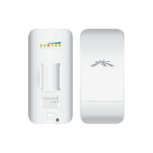

Looking at the Air Max Nano station to use with 4 Dahua IP cameras. The link is LOS at about 200 feet. Ethernet would be a good alternative choice, but due to city streets, permits and utilities make the wire route an expensive choice. Also, the Nano stations are sold out along with a lot of other lower priced options.
As a substitute, under consideration, is the the Giga Beam Plus with is more costly but has a very small form factor. The overall question is will this device work as a point to point extension for full duplex IP camera use connected to a 24 port POE unmanaged switch to BI?

Yes it would work and actually deliver gigabit speed too.
I've used Gigabeam Plus before, at about 1.2km range. Three things I would warn you about:
1) The line of sight requirement is more strict than ever with the 60ghz frequency. Don't even try it with them if you have so much as a single sparse tree branch in the way.
2) These radios have an extremely narrow beam so if they are aimed a little bit wrong you will get no link at all. May be less of a problem at 200ft, or it may be worse (maybe you just get an awful signal until they are pointed exactly right?). Lets just say within the same room for testing they were able to link at good rates just pointed vaguely at each other, but once I got them mounted at 1.2km it was like aiming an invisible laser. Took a lot of fiddling to even get them to connect.
3) Several times a day my radios would lose connection and not get it back until the radios were rebooted. Seems like a firmware bug, but firmware updates never fixed it and I could find no evidence of this happening to anyone else. Could have been related to the poor signal strength I had at that long range. I had -62 to -67 dBm depending on weather. The radios require a minimum signal strength of -72 dBm so that was cutting it pretty close. Still, when they were actually connected the speeds were great, 500+ Mbps, and latency 0-2ms. I ended up using the ping watchdog function to reboot them automatically, and ultimately replaced the radios with AF60-LR which are much better suited for the long range and have been stable.
Like @TonyR said the LiteBeam Gen 2 5AC would be a good alternative if you don't mind the larger footprint. Or the non-AC NanoStation Loco M5 if 100 Mbps speed would be enough for you. TP-link has competing products such as this one which is equivalent to the NanoStation Loco M5 with a 100 Mbps network port. Avoid 2.4GHz. Unless there are a lot of obstructions like trees that you haven't mentioned, the greater penetrating capability of 2.4GHz is a bad thing because it means increased interference.
If you do go with a 5GHz radio make sure you reduce the output power so your signal strength is only about 30 dBm higher than the noise floor (about -45 to -55 dBm would usually be ideal). Any higher than that and you are just creating more unnecessary interference for your own and your neighbors' 5GHz wifi networks.
