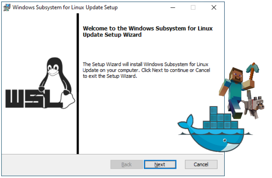

As an FYI all - I've been having my interfaces basically disconnect after 3-6 hours and have to reboot to get them back. Some of this is because I'm using an old supermicro motherboard and i cannot update drivers anymore other than what windows 10 supplies. However, I suspected that the virtualized environment had something to do with the errors in combination with my old drivers. I looked further into this and tried to get Docker to run in WSL2 hoping that I wouldn't need to use Hyper-V anymore. This panned out. I moved Docker to WSL2, and now it doesn't really utilize Hyper-V anymore. Hyper-V is still installed but not being used. This helped get my system stabilized and it's been working nonstop for 24 hrs. I haven't tried to check to see if it works logged off yet, but there's a chance that it will. I want to make absolutely sure this solved the interface instability before trying to see if it runs logged off.
I used this guide to get Docker to run WSL2. At the end of it, I had to reinstall the DeepStack container but that was just that one command line.
