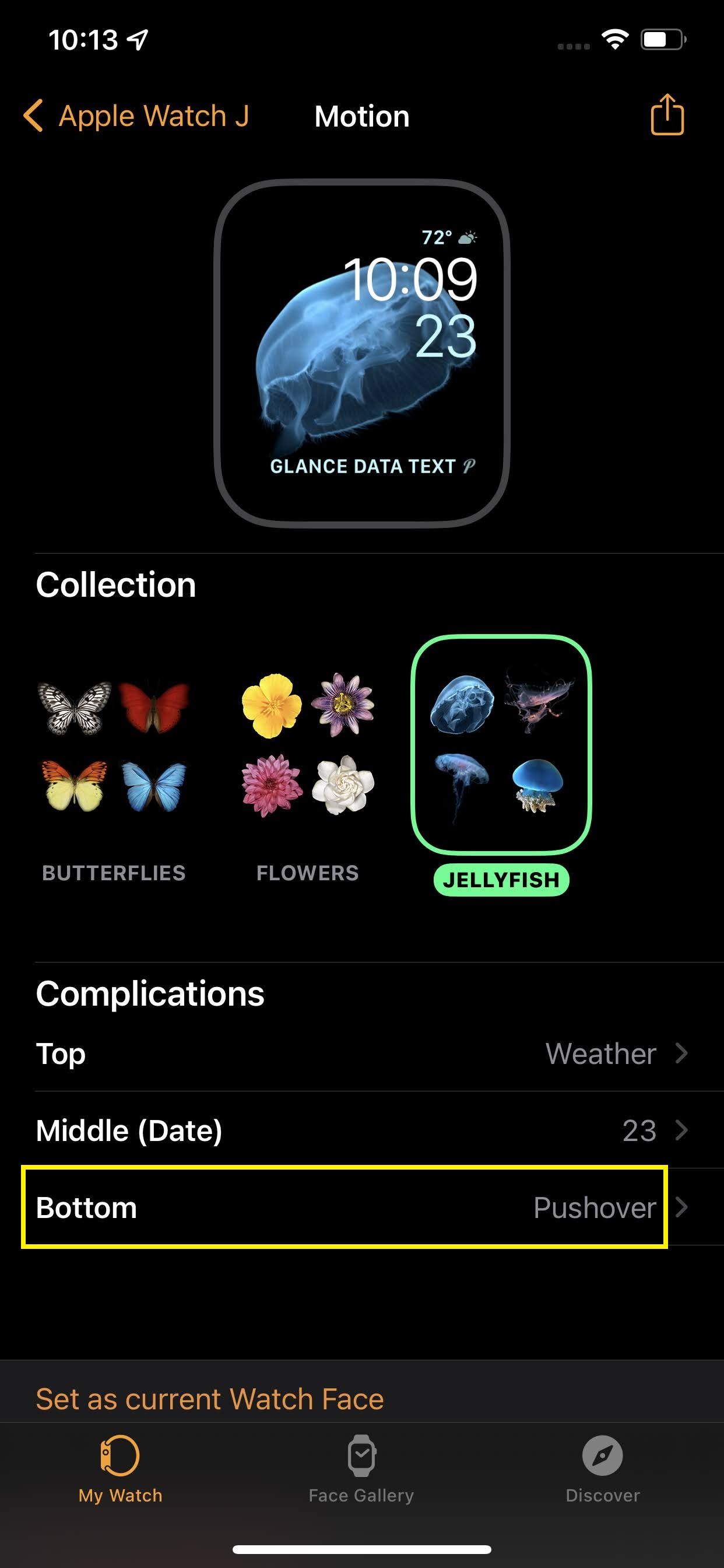

For Apple Watch users
I just got the Pushover 'Glances' API to work. You can read more about it here.
Here is my curl parameters code
Code:
https://api.pushover.net/1/glances.json -s --form-string "token=REDACTED" --form-string  "user=REDACTED" --form-string "text=hello world"
The 'tricky' part to getting this working is that you must add the Pushover complication to each watch face you use. Here's an example:

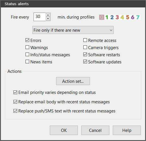

I'm not sure how useful this might really be. I'm going to try it for Status alert messages sent every 30 minutes (if there are any new log entries).

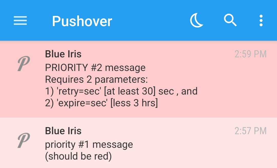

With prompting by @fenderman
Sending High Priority and Emergency Priority notifications from Pushover via Curl
Compared to sending attachments, this is quite simple!
In the code boxes below are parameter field examples you can use with curl 'Run a program' actions in Blue Iris.
You can use these to send high priority and emergency priority notifications from Blue Iris, like the following screenshot.
The Emergency Priority notifications are interesting. You can make them persistent for a given retry time and expire duration.
These parameters are required. The units are seconds.
retry must be greater than 30 seconds
expire must be less than 3 hours
About Pushover high priority and emergency priority notifications:
  • bypass a user's quiet hours.
  • always play a sound and vibrate (if the user's device is configured to) regardless of the delivery time
Blue Iris Action Parameter field examples...
High Priority notification (priority=1)
Code:
https://api.pushover.net/1/messages.json -s --form-string "token=YOUR_TOKEN_HERE" --form-string "user=YOUR_USER_KEY_HERE" --form-string "message=priority #1 message<br>(should be red)" --form-string "html=1" --form-string "priority=1"
Or just add this code to an existing Blue Iris Action parameter field...
Emergency Priority notification (priority=2)
This one will retry every 30 seconds for 5 minutes (300 seconds).
Code:
https://api.pushover.net/1/messages.json -s --form-string "token=YOUR_TOKEN_HERE" --form-string "user=YOUR_USER_KEY_H[ICODE]ERE" --form-string "message=PRIORITY #2 message<br>Requires 2 parameters:<br>1) 'retry=sec' [at least 30] sec , and <br>2) 'expire=sec' [less 3 hrs]" --form-string "html=1" --form-string "priority=2" --form-string "retry=30" --form-string "expire=300"
Add an attention getting sound argument, and you'll likely never miss another emergency notification.
--form-string "sound=MY_ANNOYING_SOUND"

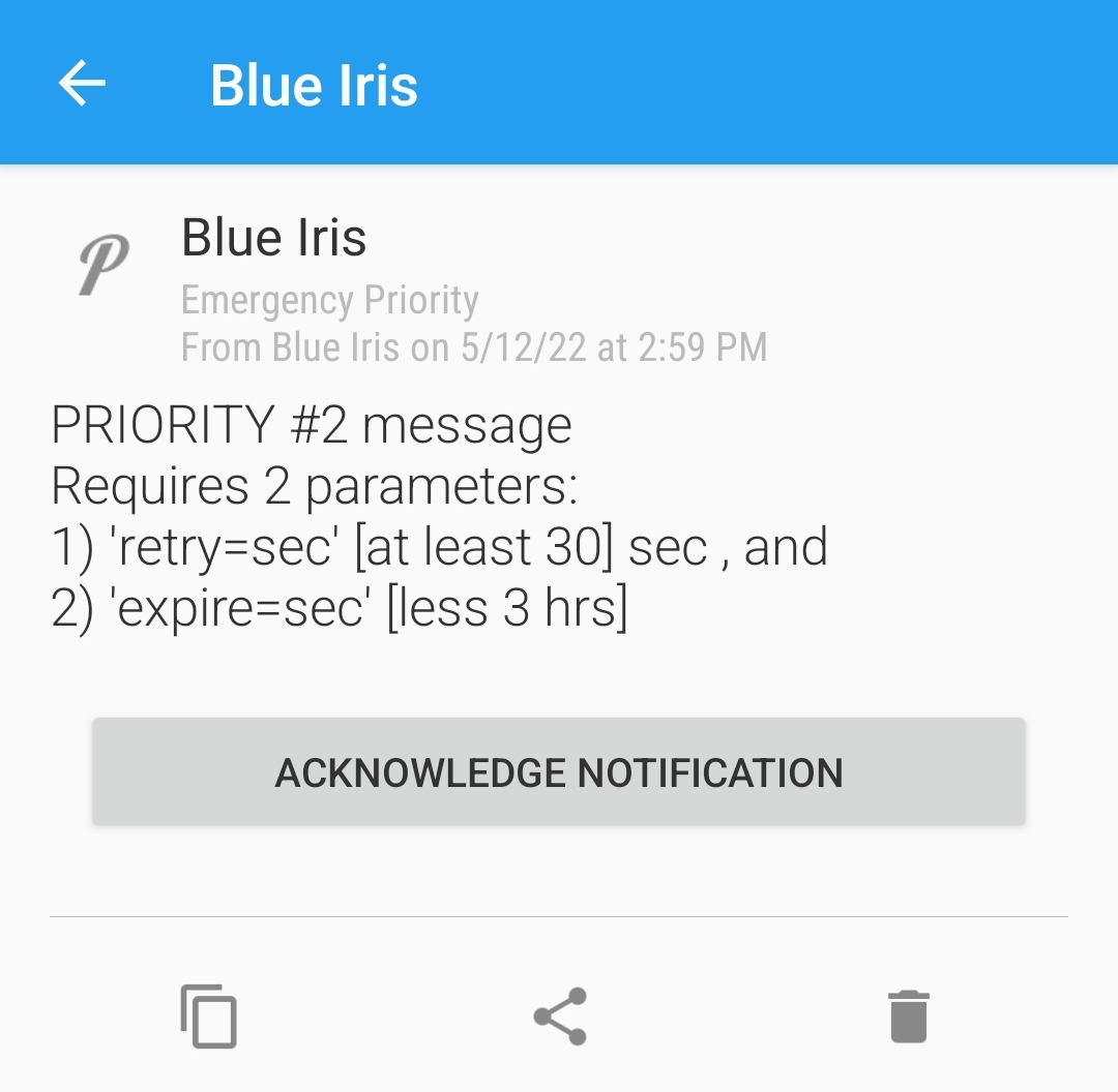

You can also check from your browser to see if an emergency priority notification has been acknowledged.
Use this URL
https://api.pushover.net/1/receipts/YOUR_RECEIPT_HERE.json?token=YOUR_TOKEN_HERE
You can test this by sending an API request from cmd.exe, like this
Copy the highlighted receipt string to use in the URL above. The URL responses look like the following...
BEFORE ACKNOWLEDGEMENT
Code:
    "status":1,
    "acknowledged":0,
    "acknowledged_at":0,
    "acknowledged_by":"",
    "acknowledged_by_device":"","
    last_delivered_at":1652391742,
    "expired":0,
    "expires_at":1652391952,
    "called_back":0,
    "called_back_at":0,
    "request":"5290df0d-491c-409e-afa0-cb65927630b1"
AFTER ACKNOWLEDGEMENT
Code:
    "status":1,
    "acknowledged":1,
    "acknowledged_at":1652391793,
    "acknowledged_by":"YOUR_USER_KEY",
    "acknowledged_by_device":"galaxy-s21",
    "last_delivered_at":1652391772,
    "expired":0,
    "called_back":0,
    "called_back_at":0,
    "request":"1763f824-7d7e-4750-b1aa-e531a460759a"

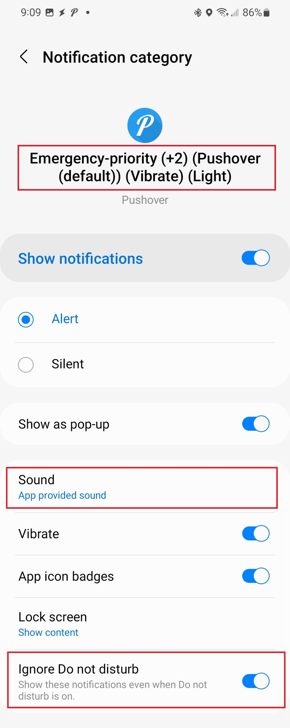

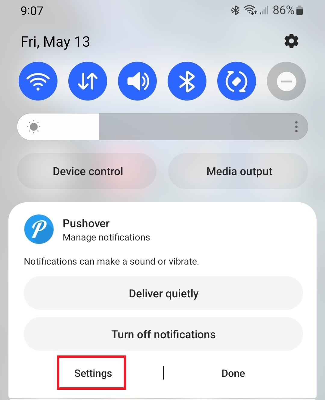

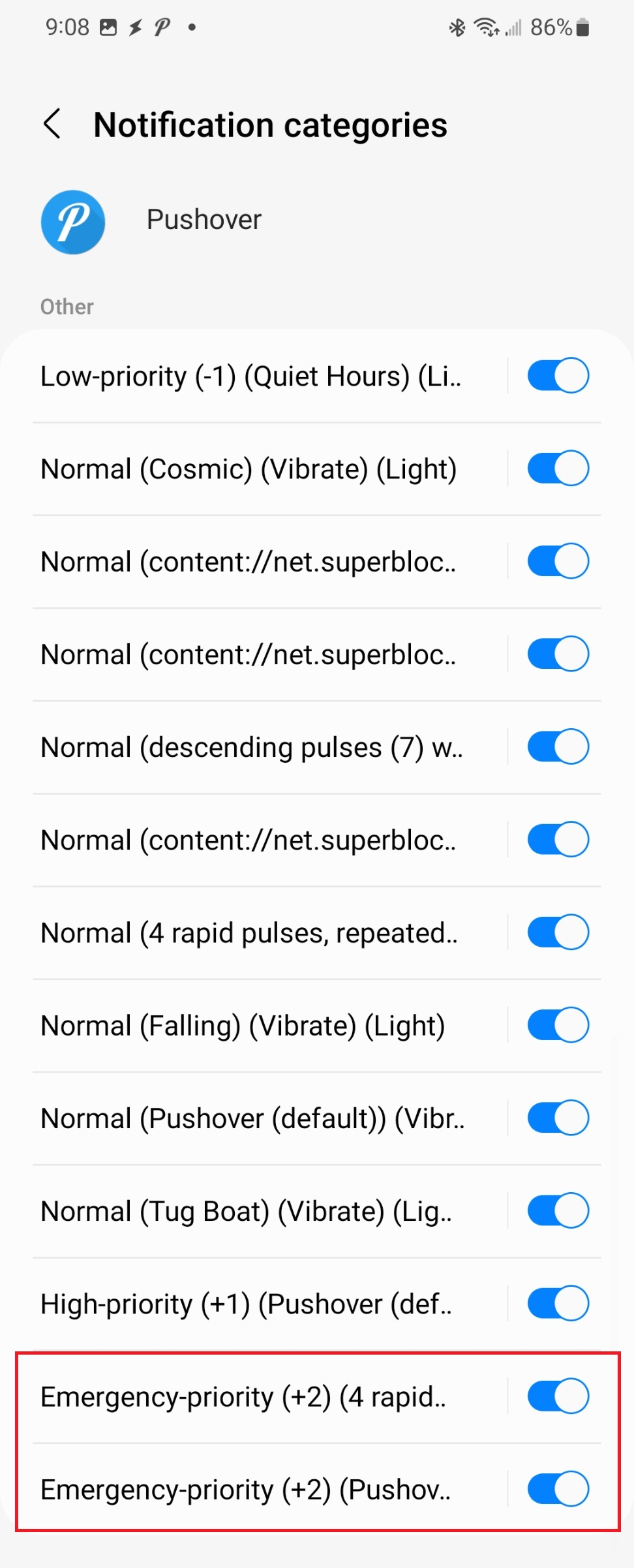

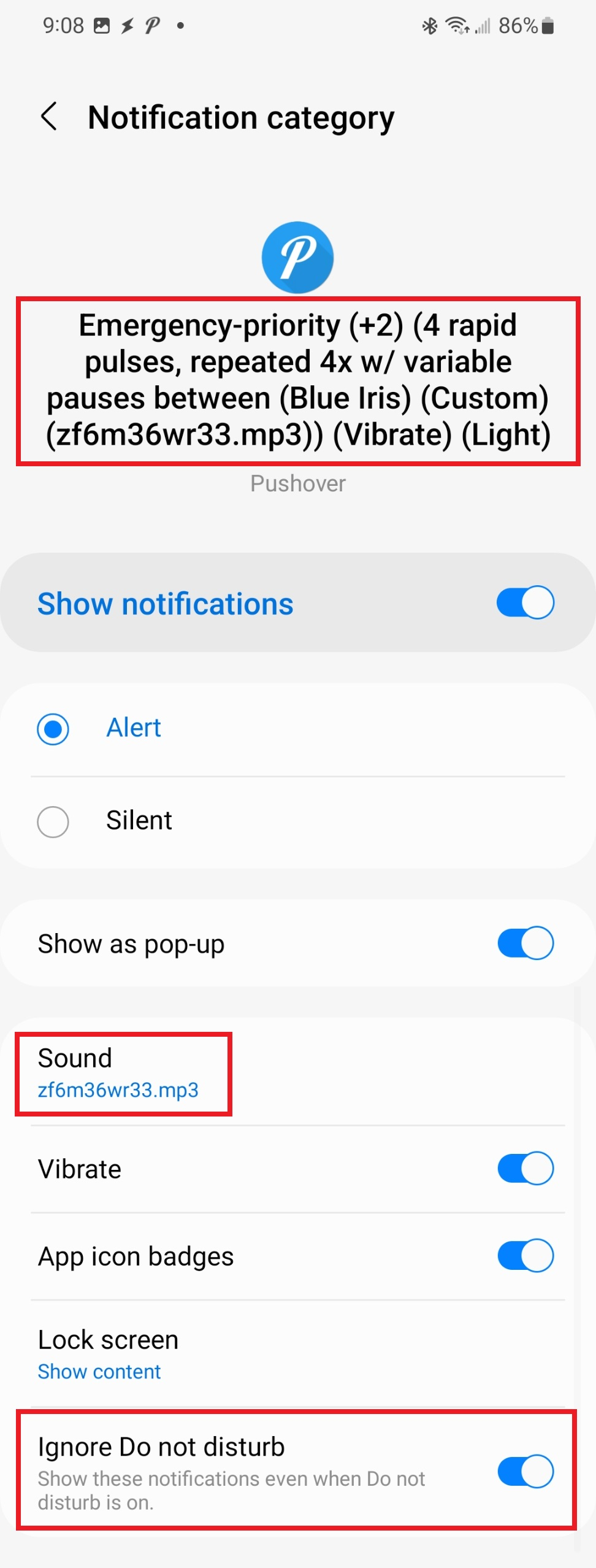

Configuring Pushover Emergency Notifications for when your Android Device is in Do Not Disturb (DND) mode
Last night while experimenting with the Pushover Emergency notification parameters, I noticed found my Android device was not responding as expected.
I then noticed that it had already entered Do Not Disturb mode.
Correcting this required learning something new (for me anyway). Below is the process in screenshots.
KEY POINTS
Test and verify that your essential Emergency notifications get through DND mode.
These steps likely need to be repeated:
  1. every time you modify (or create a new) Emergency notification (sound, vibration, etc.)
  2. if you uninstall and reinstall the Pushover app.
  3. if you restore your device.
  4. [EDIT 3/2/2024] If you migrate to a new device...
    NOTE: You may need to manually re-enable notification categories. Here's how...
    Settings > Notifications > Advanced settings > 'Manage notification categories for each app'
Even though Pushover API states the following, it is not automatic!
High priority and Emergency priority notifications bypass a user's quiet hours and always play a sound and vibrate (if the user's device is configured to) regardless of the delivery time
Procedure: (Android version 12 (Snow Cone), UI version 4.1))
1. Long-press in any Pushover notification in the notification tray (swipe down on home screen) . Touch Settings.
2. You should now see a Notification categories button. Touch it to show a list. Scroll to the first Emergency notification, make sure it’s on, then long-press.
3. You should now make sure Show notifications is on, and see the sound to be played in Do not disturb.
4. Back out of the settings screen and repeat step 3 for every Emergency notification as necessary.

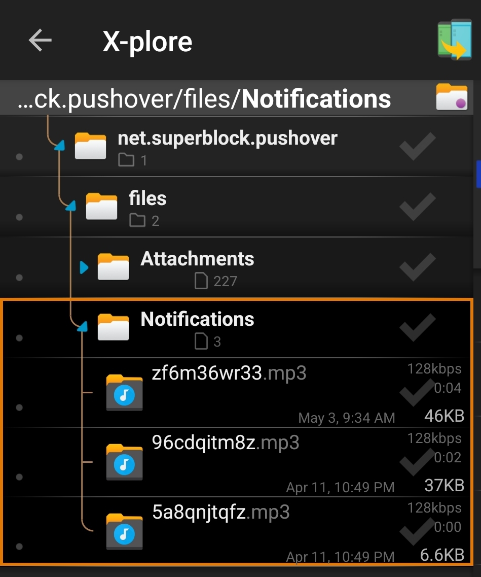

One more thing worth noting... The 2nd screenshot in Step 3 above shows an Emergency notification that uses a Pushover custom sound.
Note the title details, and the addition of a Pushover API-generated MP3 filename in the sound section.
I found this MP3 file (and several others) stored on my device here:
/storage/emulated/0/Android/data/net.superblock.pushover/files/Notifications/zf6m36wr33.mp3
