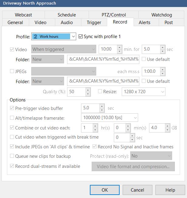

This is the first time I've experimented with saving JPEGs from the 'Record' tab, so I'm still trying to learn.
Did I really need hi-rez alert thumbnails and hi-rez images from the record tab on every camera.
My experiments so far seem to suggest that one can:
1. eliminate the thumbnails by simply unchecking "Include JPEGs on 'All clips' and timeline" on the camera 'Record' tab.
2. eliminate the excessive hi-res JPEGs by using JPEG 'When triggered' (or 'When alerted') and a snapshot interval > the trigger break time. So instead of each m:ss.s = 0:01.0, use something like 10:00.0. When I do this I get just 1 hi-res image (the trigger leading image, or alert image) instead of dozens of images!

OK, here we go...
A solution for sending Record tab images in Pushover notifications
First, let me say that is 'A' solution. It may not be ideal for you.
I've given up trying to use any macros other the &CAM in the JPEG file pattern in the 'Record' tab. Until Ken changes things, they either do not expand at all, or they are assigned their values too late.
So I'm using :
1. JPEG condition 'When alerted'
2. JPEG file template '&CAM'.
3. "JPEGs on 'All clips' & timeline" unchecked (because all snapshots have the same name, only the latest one in the clip list will point the the current image)
Any or all of these may be why this solution is not ideal for your use case.
4. A Blue Iris 'Aux' folder renamed as 'Snapshots'.

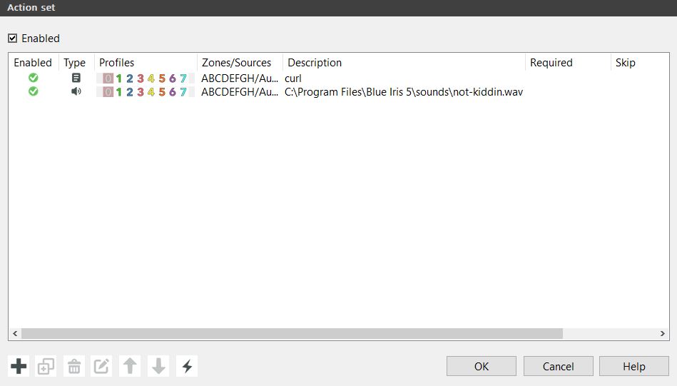

On the 'Alert' tab 'On alert...' action set I am using the following two actions.
Both use the same entry in the 'Parameter' field.
Code:
https://api.pushover.net/1/messages.json -s --form-string "token=%996" --form-string  "user=%997" --form-string "message=RecTab: <b>&CAM</b> &MEMO <a href='&WAN/ui3.htm?rec=&ALERT_DB'>UI3</a>" --form-string "html=1" -F "attachment=@D:\Blue Iris\Snapshots\&CAM.jpg"
TIP: I'm using numbered macros %996 and %997 to store my pushover credentials. I've provided more info at the end of this post..
Action #1
The reason for the 2nd action is for debugging. It creates a text file with the fully expanded API command that you can review after an alert. This can be most handy if you are not getting a notification - must often due to a typo in the attachment string.

Action #2
If everything works correctly, the entries in the 'Record' tab snapshots folder should look something like the following...
And you should see a notification like the image below. I added the text 'RecTab' note as a reminder of the image's origin..
Touching the image opens the full-res jpg. Touching the link streams the alert in UI3.

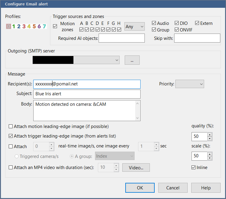

I guess the other question we haven't been able to answer is how is the generic pushover email able to get the alert thumbnail from the video, but the API cannot?
This has never dawned on me b/c I've never used the pushover email.
Now I'm curious too. I'll look over the API again.
EDIT: On the email action have you unchecked all the attach checkboxes?
