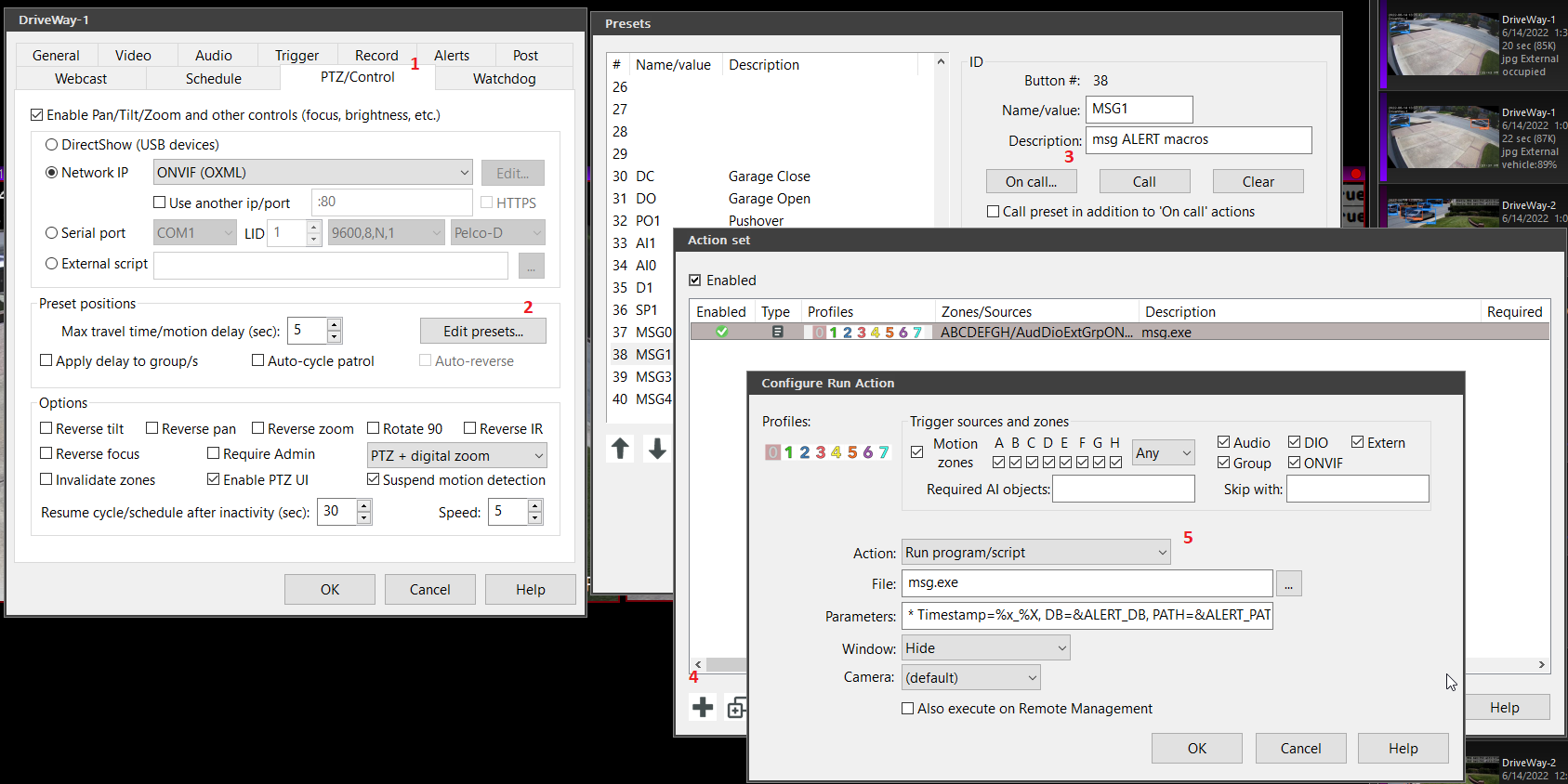

Another idea... You can try monitoring changes to the &ALERT_PATH value by using the 'msg.exe trick'.
1. Assign the following action (screenshot #1) to the 'On call' action set for preset on a camera.
2. After a trigger, keep clicking the preset every 2-15 seconds (pick a duration).
3. You'll get a msg box for each click. But you'll only see the last one.
4. When you've done this as long as you want, close the displayed msg window, then the next will display, and so on... (you might want to take screenshots of each msg box).
Perhaps this will reveal if/when changes occur to &ALERT_PATH macro.
Paste this in the 'Parameters' field.
* Timestamp=%x_%X, DB=&ALERT_DB, PATH=&ALERT_PATH
This is what you see after each preset click.

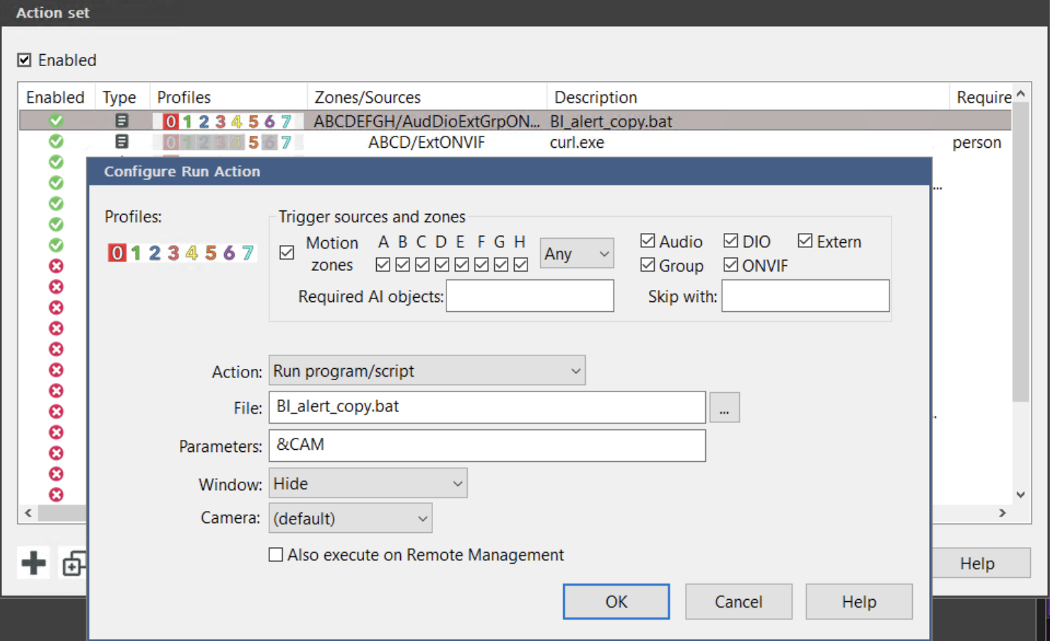

Attached is a batch file you can execute before the action that executes the Pushover curl action.
Here's what it does:
  • It identifies the most recent alert jpg for a specified camera and copies it to a folder of your choice, naming it 'camname_latest.jpg'.
  • It then loads the full filespec for the copied jpg file to Blue Iris macro no. '777'.
How to use:
  1. Edit the batch file 'user settings' to set your Blue Iris alerts folder, webserver address, etc.
  2. Edit the pushover curl command to point to macro %777 instead of the Blue Iris alerts folder. i.e., -F "attachment=@D:\Blue Iris\Alerts\&ALERT_PATH" to -F "attachment=@%777"
I've tested this on one of my cameras and it works.
If I was using this on multiple cameras I'd edit the batch file to save to a different macro for each camera. This would avoid conflicts if several cameras were triggering at the same time. EDIT: for this option, check out attachment v2.
How to use:

jaydeel
Nov 9, 2016
1,152
1,256
SF Bay Area
If I'm understanding the question, then no. The batch file creates the macros (overwriting existing contents, if any).
The batch file uses a Blue Iris Http interface command. Aside from directly editing the registry, this is the only way to create/edit high number macros (the max is 999).
