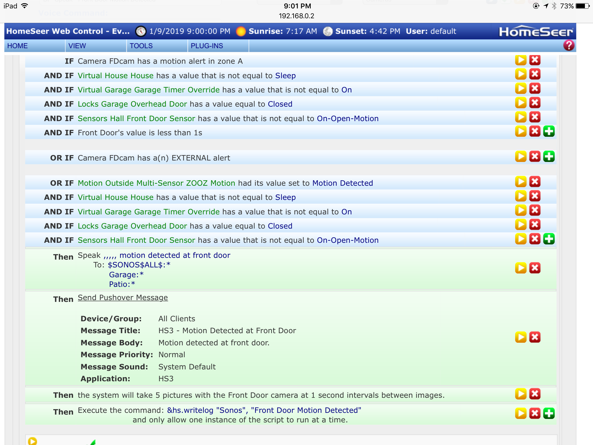

Perhaps another HA system? HomeSeer is kind of expensive, but it can include a Blue Iris plug-in for an additional cost, in case there's also a plugin for your alarm system.
I had created an event in HS3 which whenever the front gate is opened, a PTZ camera will zoom to the gate's preset. That camera has been cloned to email out an alert with a snapshot of the gate whenever the z-wave magnetic switch is opened; as HS3 will command the cloned camera to become triggered.

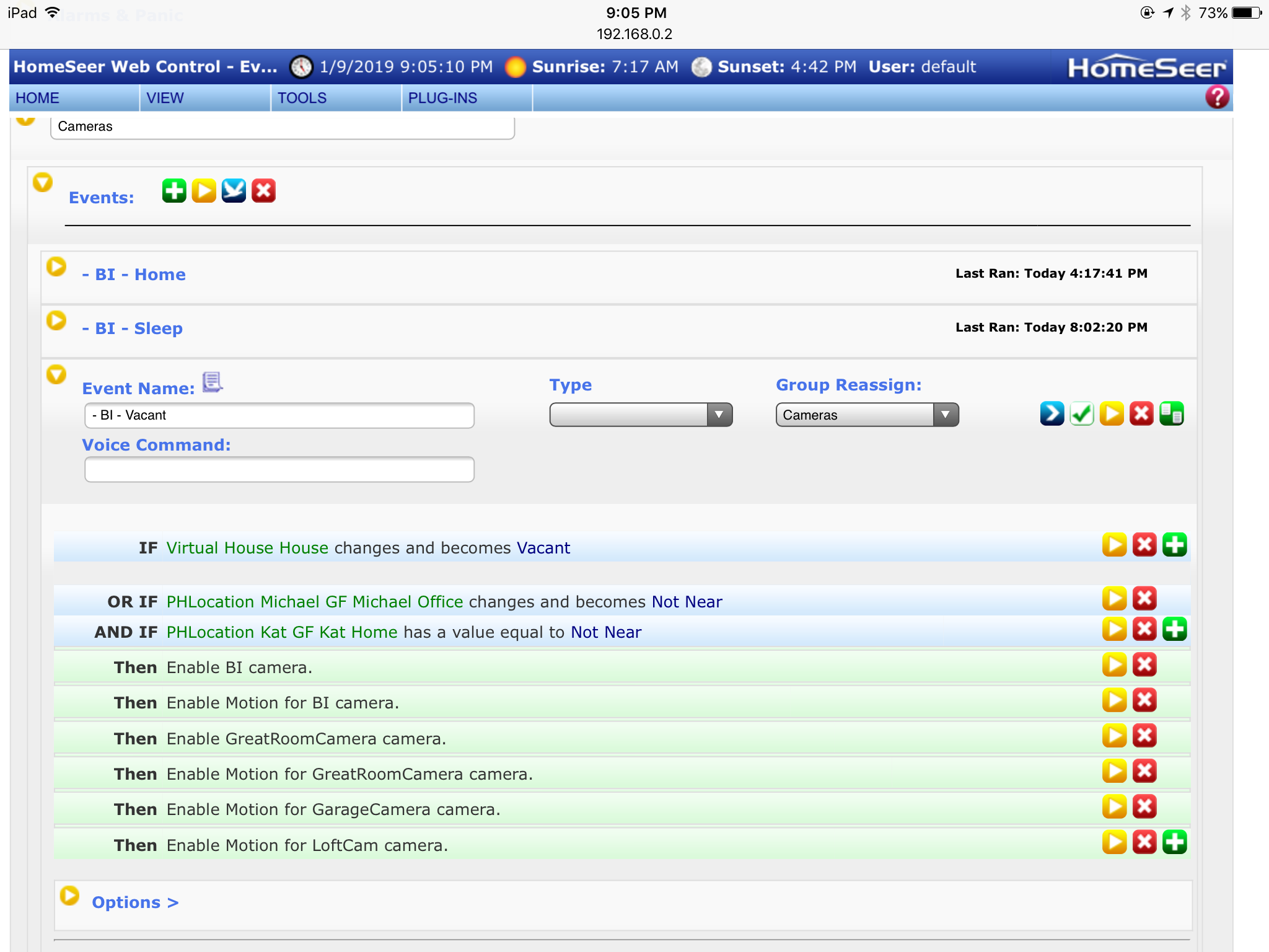

We use HomeSeer. We also use the Blue Iris plugin and Pushover plugin. This way the cameras can be isolated from the Internet.
When an event that we wrote fires based on a motion trigger from Blue Iris to the BI PI, a number of things may/can happen, one of which is a Pushover message to our phones and tablets. An email could also be sent from HS3 but we prefer the instant notification from Pushover.
