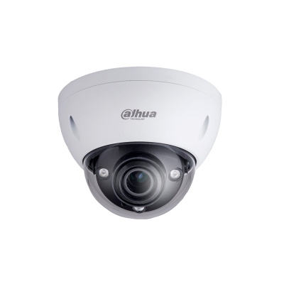

Domes are going to be kind of bad for that. Even with a "hood" you'll still often have rain/mist/condensation on the dome. Don't think that there's any easy solution for that other than something else which will at times have some of the same.
Hard to see in your image. It's this one:

indeed Mike that's the one on a vertical mount junction box Dahua PFA138.
so basicly the camera is flipped 90° up compared to your image

Yeah, a dome exposed like that will be problematic in the rain. Need a cover or a bullet or turret camera to minimize the surface area for rain to cling to and mess up the image.

Domes are bad for all sorts of reasons, and should be avoided, including this reason.
You could try changing the mounting of the dome to horizontal, so the dome is on the bottom instead with this mount:
PFB210W
But best solution is to use a turret camera mounted to the correct mount such as this:
With this mount
