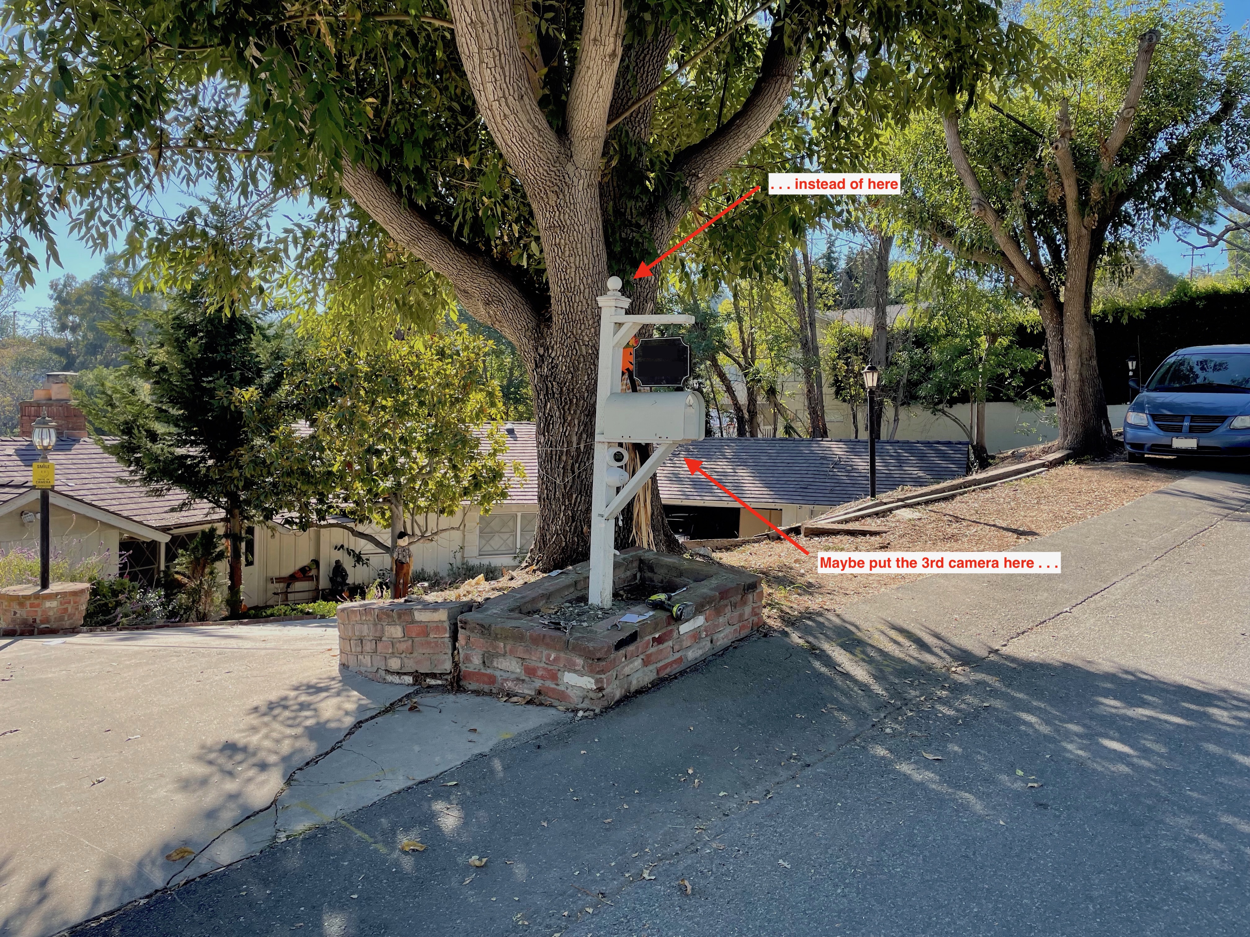

TL;DR: How to trigger 3 cameras in BI when my mailbox is opened?
Long version: After a spate of neighborhood break-ins, it's finally time for me to install cameras out on the street. I have a BI 5.5.2.5 installation running 12 cameras on renewed Core i7-6700-based PC. I live at the end of Tee, and my mailbox is pretty much perfectly positioned to see down the Tee as well as in both directions of the cross street.
Although my initial thought was to replace the ball on top of the post with an eyeball camera, I'm now realizing that it'll see that horizontal wood piece that the brown sign hangs down from. I haven't placed a camera there to try it yet, but just based on my expected FOV, that's going to block a lot of the image. So now I'm thinking of putting the 3rd camera on the diagonal wood piece holding up the mailbox:
The two other cameras on the post are Amcrest IP5M-T1179EW. They work pretty well, but the mounting ring is just a tad wider than my wood, as you can sort of see in the photo. It would look worse on that skinny diagonal piece. Any suggestions for a camera (or mounting ring) that would be lower-profile on that diagonal?
So if my third camera is going here:
I can significantly reduce its profile by making a hole in that diagonal 2 x 4. I don't know any easy way to make a hemispherical cavity, but I have hole saw and a quarter round router bit. A round-nose bit would be better, but I don't own of those. Yet.
If I do this for real, I'll do a better job of centering and setting the height. But it does a decent job of recessing the camera:
But now I need some sort of a retainer ring. Any ideas?

Can you enlarge the recess on the back side so the cam sits down into it more? i.e., Come in from the rear vs finding something to hold it at the front.

What about adding a second 2x4 on top of the existing 2x4 that is holding the hanging sign. This would double the thickness. Once that is completed you could carve out a space that could hold your round camera at the end. Most of the body would be embedded into the two 2x4's and the camera would be at the tip and at a good height.
Further, you could run the cable in between the two 2x4's (use a router to make a channel in the new 2x4)
I would certainly consider that if I could get to the back side of that piece. I'm pretty sure I nailed it in, as opposed to screwing it in, when I built the mailbox post, so I don't know how feasible it would be to disassemble. Disassembly would make any approach easier, so I'll look at it tomorrow when it's light again.
