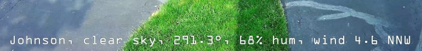

I have the new Weather API working, but I am trying to find a way to display the temp and wind speed with more precision. I would like to display the values to at least one decimal place. Is there a way to do this?
If you mean the openweathermap current weather API, it does return temperature and windspeed with more precision, which Blue Iris macros %053 & %057 apparently return as rounded or floor integer values.
You will need to email Blue Iris Support and request new macros like %053 & %057 that provide the same precision as returned by the API.

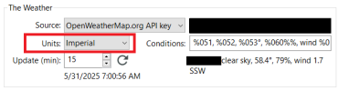

Keep in mind, it took a few hours for my key to work in BI, it said active on OpenWeatherMap.Org but would not work in BI. You will know when it works as it will populate the conditions and won't get an error message. No need to put CC info in or nothing for the free API service.
I guess I need some hand holding here. Are there more in depth instructions somewhere? I shut down BIT and deleted the macros that came from BIT. Was I wrong to do that? I entered my key on the Location tab of BI. I'm not sure how to proceed from here.
