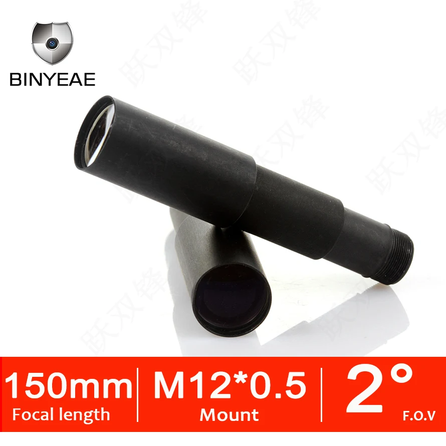

Wow, thats a long ways. just for fun I ran into this thread awhile back.
! cant believe they even have lenses this big, lol.
good luck!

Also, the idea interchangeable lenses is very interesting. Still reading through the different lens mount options and need to find a camera with a lens mount that is okay for exterior exposure.
