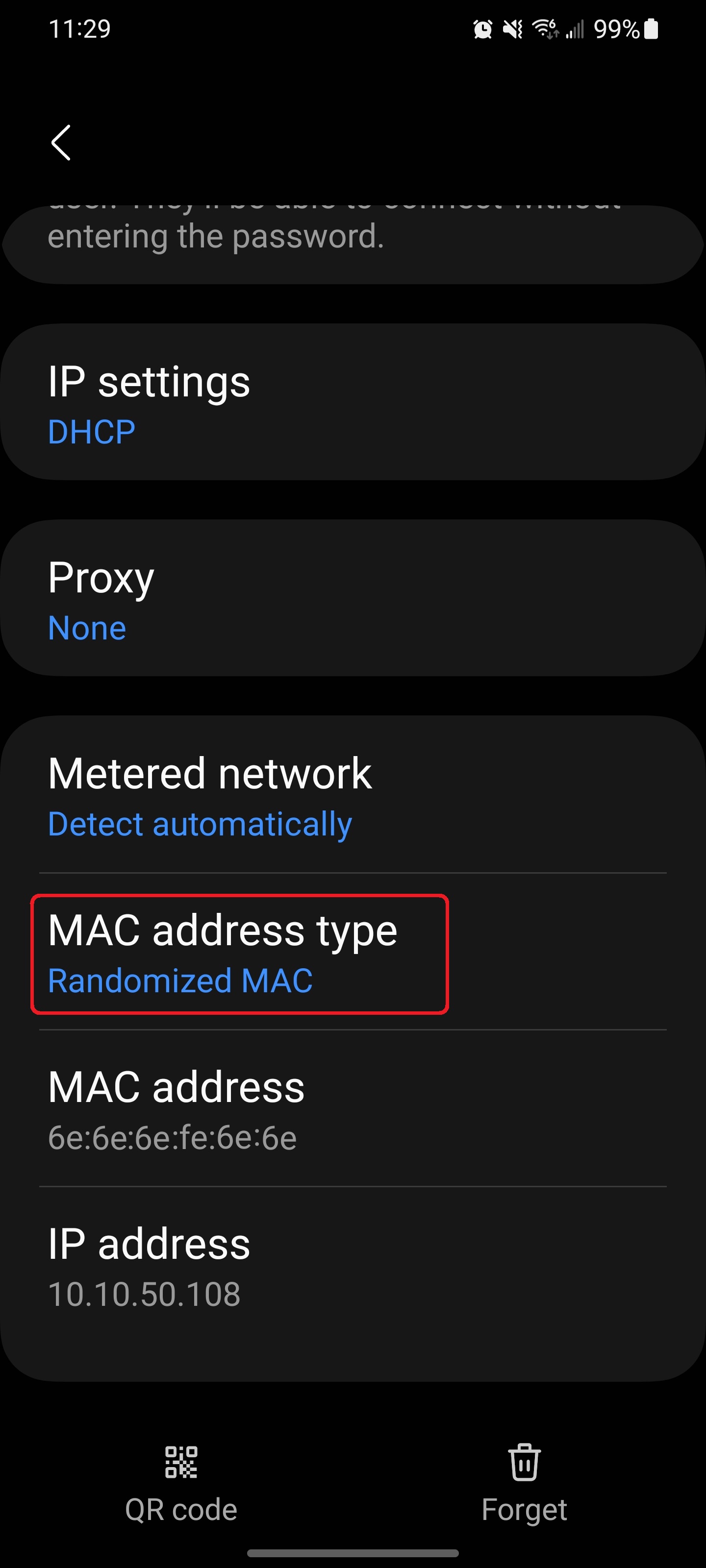

I set my phone to have a randomized MAC address. Pretty sure that was the default setting of the phone too.
Reactions: aesterling
Randomized MAC address just creates a randomized MAC Address for that specific SSID / network profile. When you return / reconnect to that same SSID your phone will still be using the same Randomized MAC unless you manually force it to generate a new one.
Reactions: MikeMakesWhiskey
