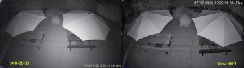

That's great! I currently have a couple IPC-T54IR-ZE (4MP 1/1.8" image sensor) cameras in my backyard, which is in total darkness at night. The IR on those cameras just don't cut it. They illuminate a circular area, and all around that it's dark. I need to see a wider area. Do you know if the IPC-Color4M-T would do that? I'm thinking of external lighting but am hoping one of Andy's cameras would do it instead.
In my backyard I have a camera mounted high at the top of the house and looking downward. As with your photo, it is in complete darkness and with a T54IR-ZE-S3 the IR illuminated a bright spot in the center. I won a Color 4M-T in Andy's lottery and replaced the T541R with the Color 4M-T. The IR is much more balanced and spread. The Color 4M-T is a great camera.
