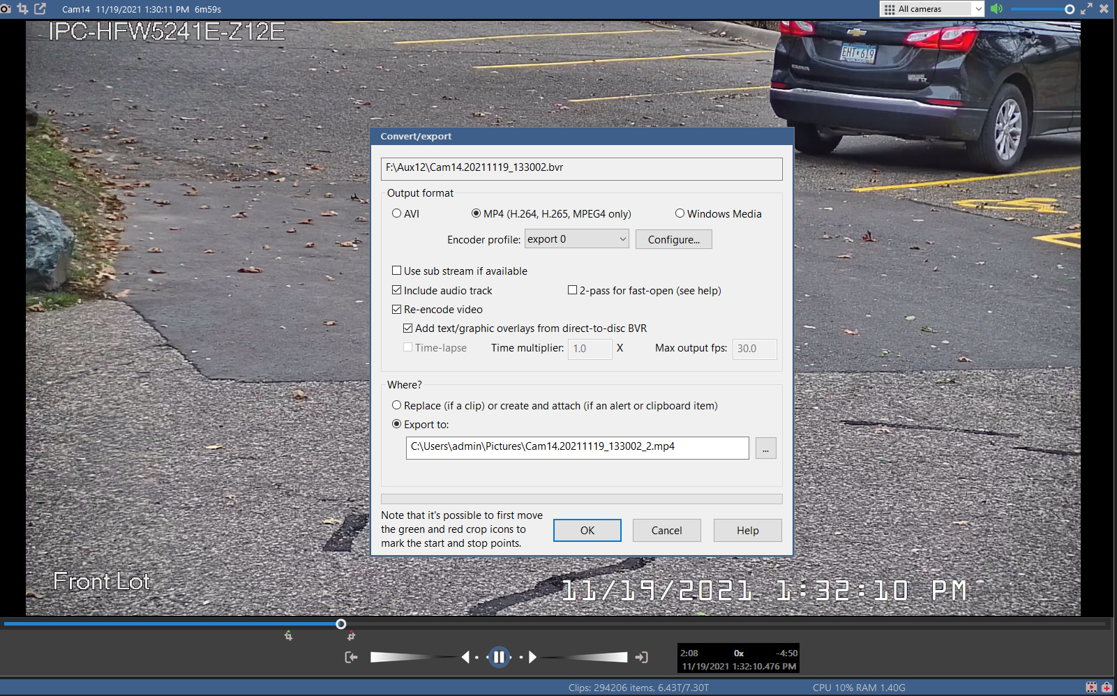

are you doing " combine or Cut each Video ____ hrs ____min ____GB? on each individual camera?
if so rather than save by size, try saving by time? like clip each video every 5 min or 0.5 GB? maybe experiment a little.

mine is set to clip every 15 min or 4gb, not sure which comes first. Probably the time.
so I checked a 5MP camera.
it's clipped about every 500MB for 15 minutes of idle video,

but im looking at folders that are in .bvr format.
If your exporting motion events, and choosing .mp4.... slide the red and blue sliders to shorter period of time.

I was only looking at the general settings, but as you said, I went into the individual camera settings and see the time/gb limit, so I can adjust that and it should take care of my issue! Longer term I should probably get a better video editing tool, but this should work in the meantime. Also, I guess if there were a way to export only a portion of the 4gb clip that would be fine also, but didn't seem to see a way to export only a portion of the clip to mp4. Thanks again.
