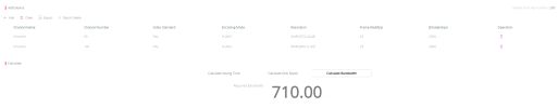

Hello, I've bought DS-96256NI-I24 NVR and i plaaning on installing 140 8MP Bullet camera & 60 6MP turret camera on very largae area.
So I've installed around 160 camera in total now and i have many camera down due to No enough network bandwidth, And when i checked NVR traffic in the NVR i saw its around 1GB, So I've changed all camera to start using H.265+ and delete all camera and then re-add them,
Now around 140 Camera is working and 20 is down to same error, When i checked network traffic its around 280-300 MB, The NVR can handle 768 Mbps of traffic! ( All camera updated, NVR dont have update ).
When i did the calcaltuinos it should all be just working fine even with the 250 Camera.
So why im getting bandiwth error now when the traffic got lowered into 280MP ?

2. it's not how much network bandwith is used by camera. But how much bandwith is reported by camera as maximum which can send.
Can you show what encoding settings (all for main/sub stream) you have on both 8MPx and 6MPx cams? h265+ (plus part, not h265 part) can be a problem here - I don't know how HIK cameras calculate max bitrate here..
3. there is risk when you deleted all cams, NVR didn't subtract counters properly.. In that case, you will need to default to factory NVR and add all cams one more time.. but before that, show your encoding settings on all cams...
4. your NVR have 768 MBps network bandwith.. with 200 cams, this is 3,84 Mbps per camera (both main and sub stream)...
