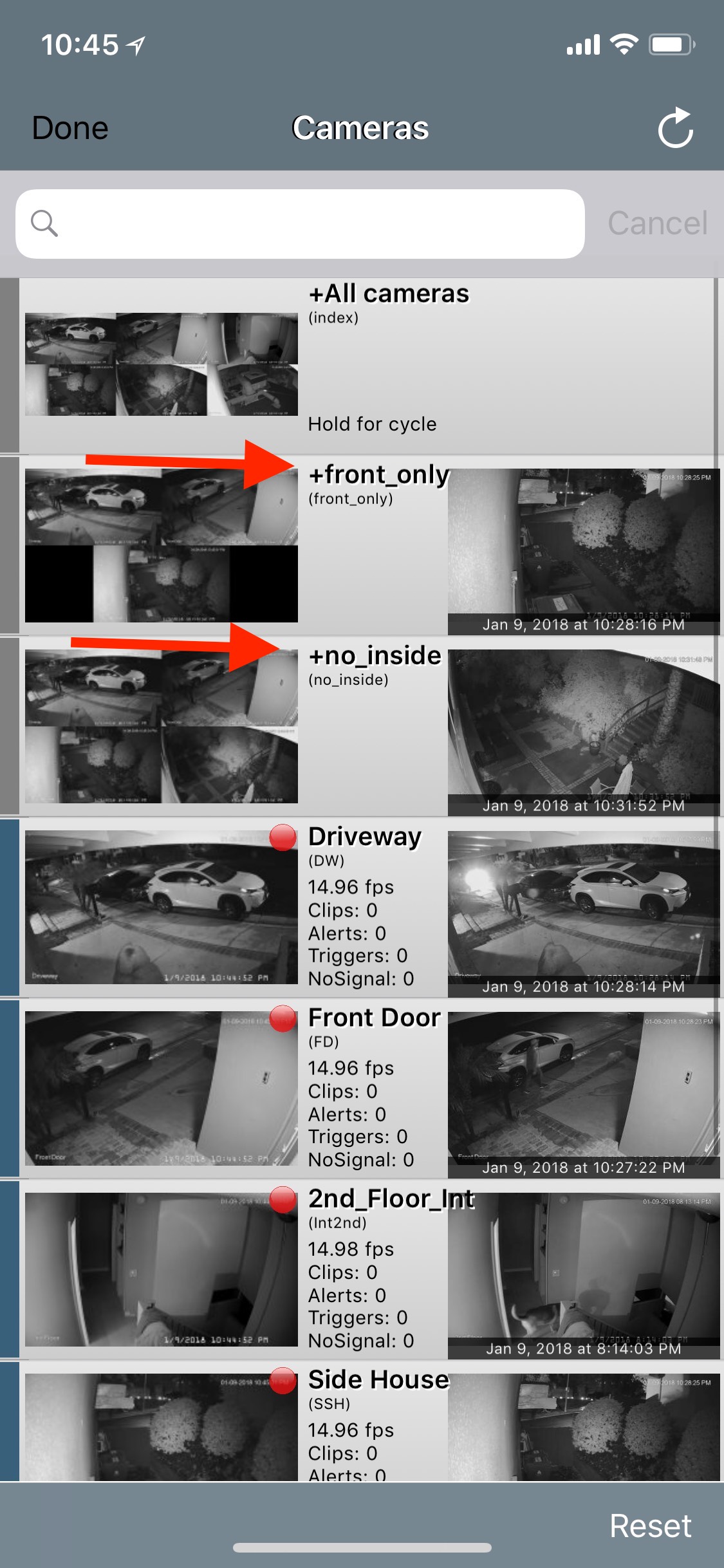

darrenph1
Feb 10, 2017
108
42
On iOS you should be able to cycle through any camera group by using the press and hold function. I have several groups setup and this works on both my iPhone and iPad.
I'm not having any luck doing this. See the pic. On both my iPad and iPhone I can press and hold on either of the 2 groups below the all cameras group but it just goes to the group, it does not cycle. Does it look the same on yours? Maybe I'm missing a setting that needs to be messed with in BI??

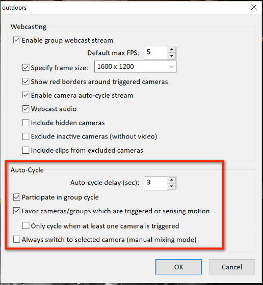

Vettester
Feb 5, 2017
755
715
All my groups have a "Hold to Cycle" option at the bottom. This needs to be enabled in your group options.
