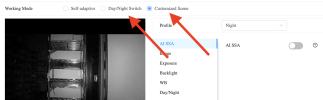

With Web 5 cams it is possible to have finer control of when the camera switches between modes. In place of just day and night add general or custom 1 or custom 2 using time plan settings to make adjustments to shutter, gain, etc.
The overall concern is that this is a time based solution that has to be reset once per month to take into account changing day/night lengths. Plus there is no compensation for cloudy vs sunny days or for those living in the far north or south where day length can change up to 10 minutes per day in the extreme north or south.
I just had all of my cameras do their own thing because I had entered a set of Time Plan settings, so I just clicked Clear on all of my LPR cameras:
Using the API that works for Web 5 day/night mode switch and have the Web 5 cams set for "Customized Scene". However, using Hubitat and HTTP GET statements for cam day/night mode switching based on LUX and not time.
and I'm hoping that will stop the cameras from switching on their own, and rely only on the new service.
I'm about to embark on changing my Web 5 camera profiles via the API myself, and wondered the same thing about whether or not the camera would continue trying to mode change itself. I had the same idea as you, clearing out the Time Plan section in hopes that would just disable the time schedule based changes allowing for fully external control of the profile.
Can you confirm if this worked for you?
I do not have this working yet, and I haven't had time to properly debug it. The revised app does send the new mode, and the cameras confirm that they have received the new mode, but the settings don't actually get applied. I'm still trying to grok what "Working Mode" means, and how it applies "Profiles", e.g. what gets inherited from what, and what overrides what. It's not at all obvious!!!!
