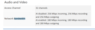

I need camera monitors at 5 locations in an office setting. My plan is to use Android TV boxes and install the DMSS app on them to stream from an Amcrest NV4232-EI
My question is does anyone have experience doing this with 5 apps running at the same time?
I'm just wondering if it'll be too much of a load on it.
This NVR won't be doing any recording, only streaming to the 5 apps, and will only have the second low resolution cameras on it.
I have Empiretech NVRs recording the same cameras in the HD stream.
thanks
Under the same account, normally can support 5 app users, but better ask Amcrest.
For our 5 series NVR there is no problem.
How many cams you have on this amcrest NVR, what is resolution. Then can calculate how many devices can do live stream.
I have 2 Dahua / Empiretech 16 channel 5 series NVRs. Both have 16 cameras recording the HD stream. The plan was to use the 32 channel Amcrest AI NVR running 32 cameras in the low resolution stream. 704x480 to do the streaming to the DMSS app. I picked the Amcrest NVR because of the cost but if the Dahua 5 series 32 channel will definitely do the job I may go with it.
