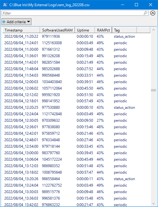

Powershell's built-in 'GridView' cmdlet is an excellent, lightweight alternative to Microsoft Excel for inspecting CSV files. It is fast and extremely capable, including a robust filtering capability... If you use the provided registry tweak (*.reg file), you can add a right-click context menu entry to use GridView with any *.csv file in Windows Explorer (see 2nd image below), or in an Internet browser download toolbar... To learn more about GridView click here (v5), and here (v7). To learn about how to use filtering and other features, click here.

Screenshot of the PowerShell 'Out-GridView' cmdlet.

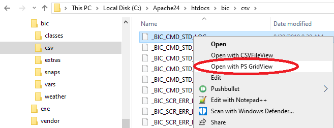

Example using the PowerShell 'Out-GridView' cmdlet via a right-click context menu in Windows Explorer.

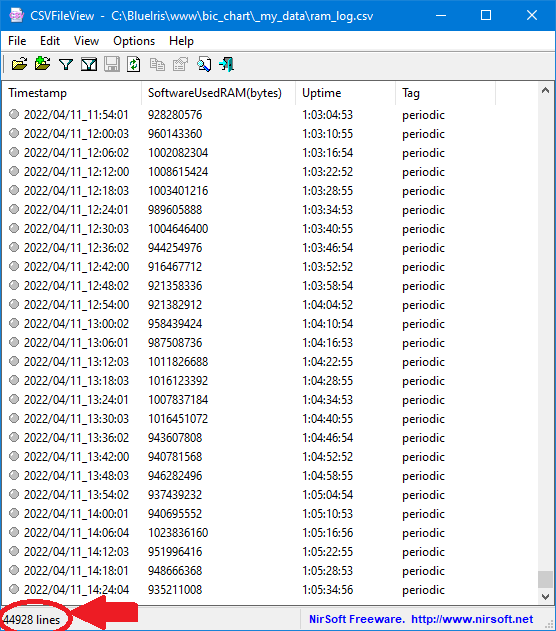

2. NirSoft CSVFileView (NirSoft):
Why you may want to use CSVFileView ...
CSVFileView is a free 3rd-party CSV viewer. It is a decent alternative to PowerShell's 'GridView' cmdlet (above), albeit with some limitations for very large files, and a more complex filtering interface. You may want to experiment with both viewers to determine your preference (or use both like I do, depending on my need)... If you use the provided registry tweak (*.reg file), you can add a right-click context menu entry to use CSVFileView with any *.csv file in Windows Explorer (see 2nd image above).
CSVFileView has these advantages versus the Windows PowerShell 'Out-GridView' cmdlet:
Total row count is displayed in the lower-left corner...

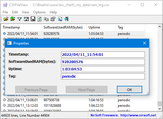

Double-click on any row to access individual cell values...

csv_file_view_context_menu1.reg | (in attached registry_tweaks.zip) registry tweak to add *.csv file context menu support for Windows Explorer |
Notes:
- The 'Out-GridView' cmdlet does not show the number of rows in the file. NirSoft's CsvFileView (below) does not have this disadvantage.
- The 'Out-GridView' cmdlet may hide underscore characters in header labels. For example label 'Mainstream_FPS' may be displayed as 'MainstreamFPS'.
- The 'Out-GridView' cmdlet may have problems if the first header row label contains a '#' character.
- The 'Out-GridView' cmdlet sometimes seems 'picky' and will not load *.csv files that will open using NirSoft's CsvFileView (below). For this reason you might want to install both tools.
How to use GridView ...
NOTE: If you've never used PowerShell on your Blue Iris PC, you will first to need to change its default security policy. Open PowerShell and type the following, then hit the Enter key:
Set-ExecutionPolicy RemoteSigned
... (click here for a nice beginner's tutorial to using PowerShell).- Copy the 'GridView.*' files to your batch folder, typically 'c:\bat'.
- If in #1 you used a folder other than 'c:\bat', open the *.reg file and edit it accordingly.
- Double-click the *.reg file and allow it to change your registry.
- Right-click on a *.csv file; select the desired option.
- CSVFileView shows the number of rows in the file (see the lower-left corner).

- CSVFileView allows cell values to be copied (double-click on a row to access individual cell values).
