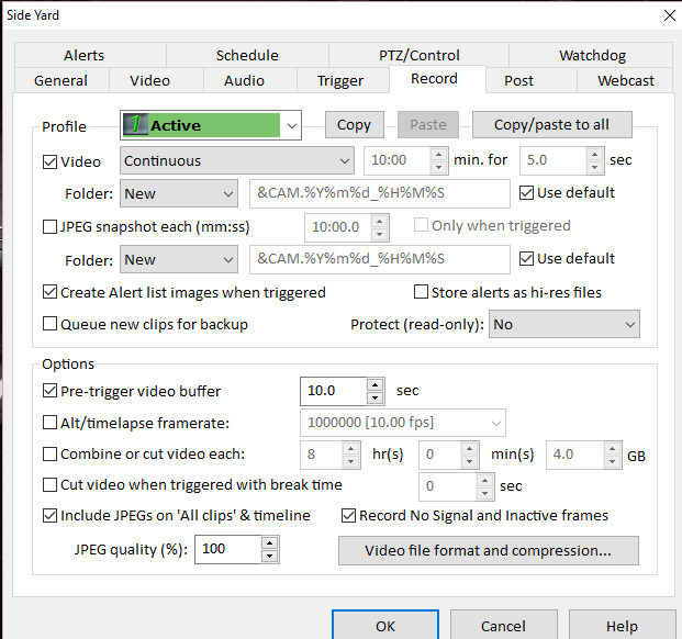

Post your record tab settings

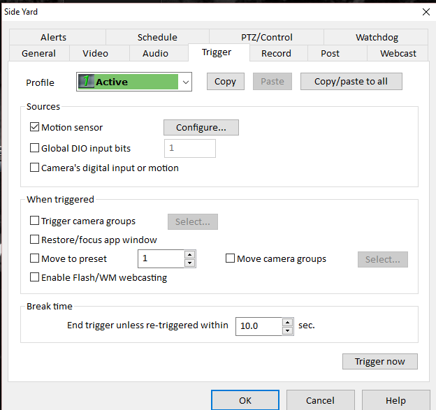

Here is the triggers. One thing I did change on the recording tab, was the include JPEGs on "All clips" thing at the very bottom, and it is now showing me a screenshot on the right side. But it also, won't open it. When I double click that jpeg, it says the file cannot be found.

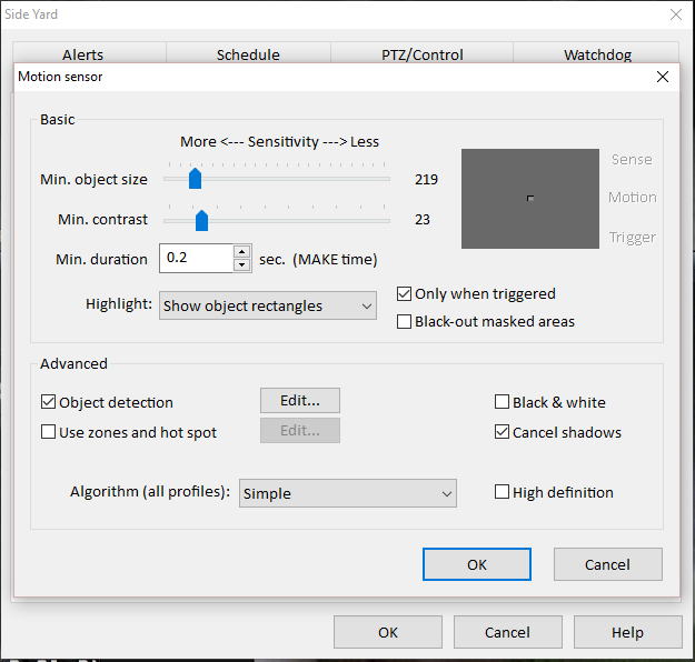

The actual motion settings...
Also uncheck show jpeg
