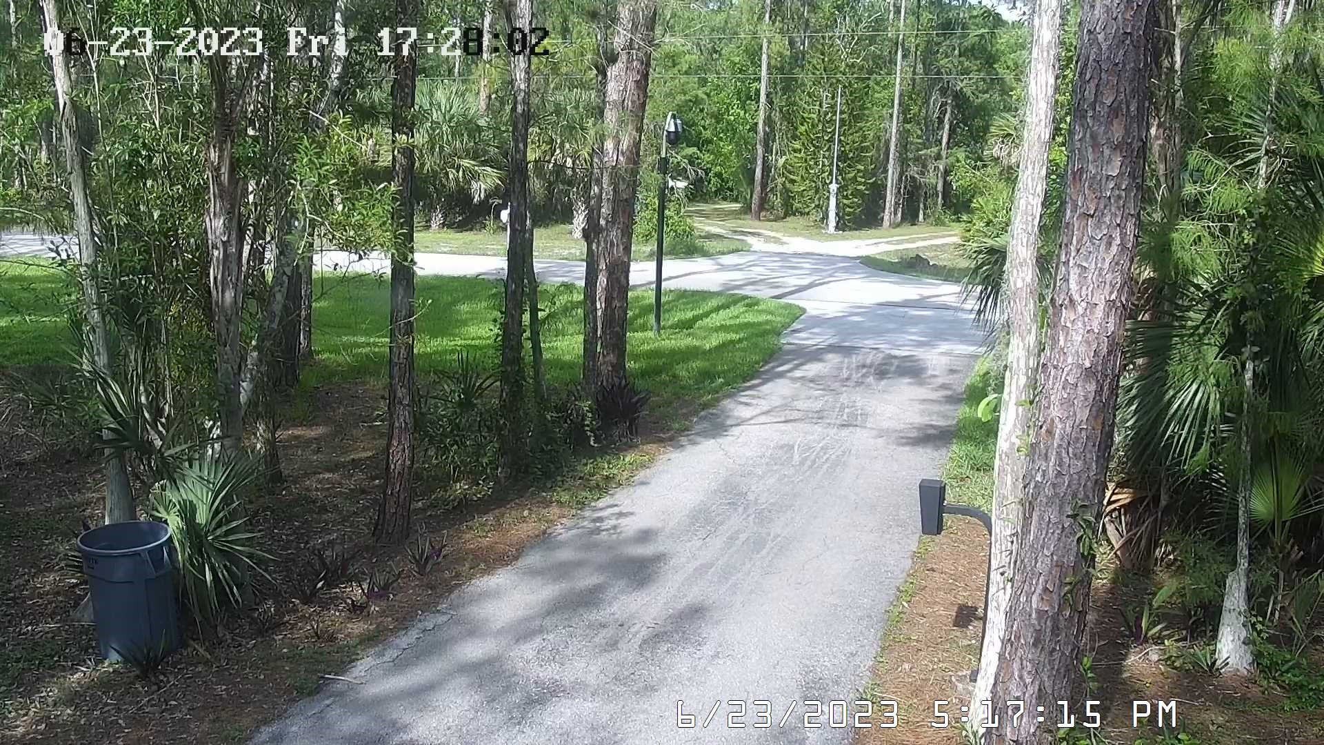

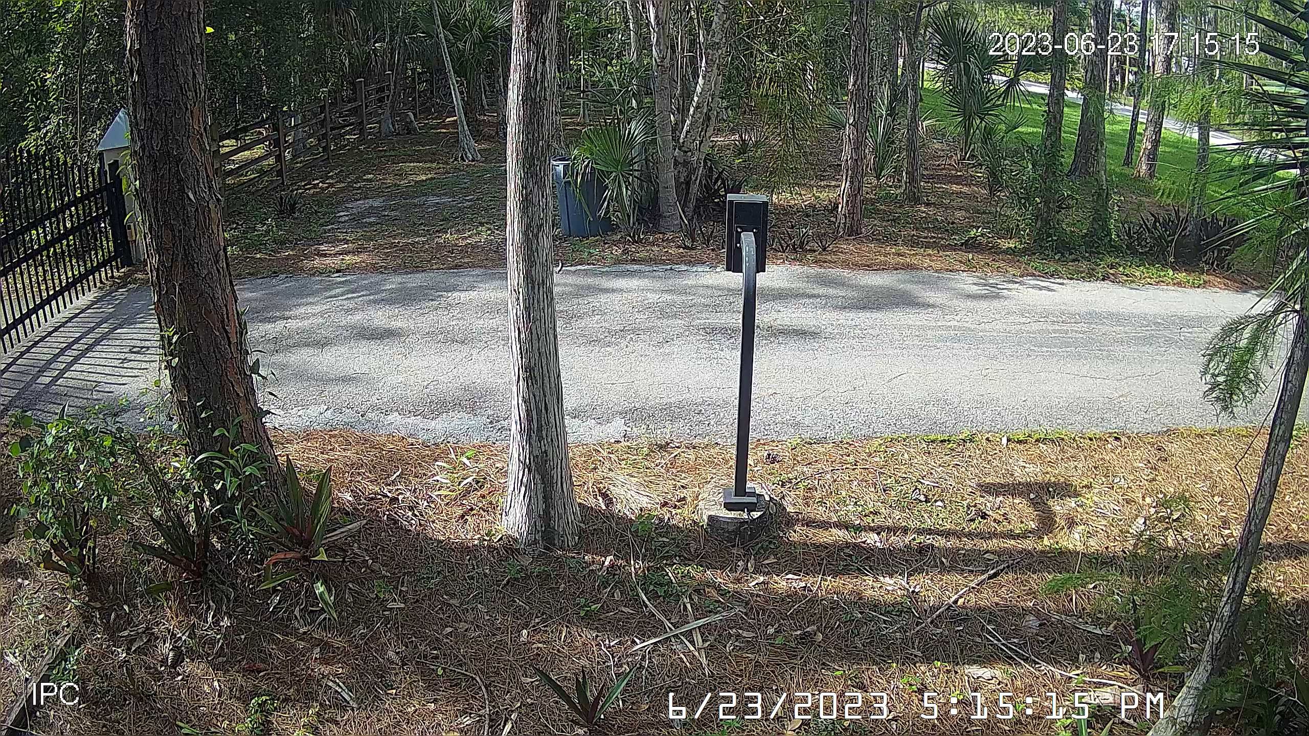

and allowing me to trigger a dry contact to open a gate?
Coldair IPCT+ Member Joined Sep 19, 2015 Messages 956 Reaction score 1,217 Location Naples Fl Jun 23, 2023 #1 and allowing me to trigger a dry contact to open a gate? Attachments CallBox203.20230623_171544540.8.jpg 2.2 MB Views: 108 PZ227.20230623_171743557.9.jpg 837.1 KB Views: 95
