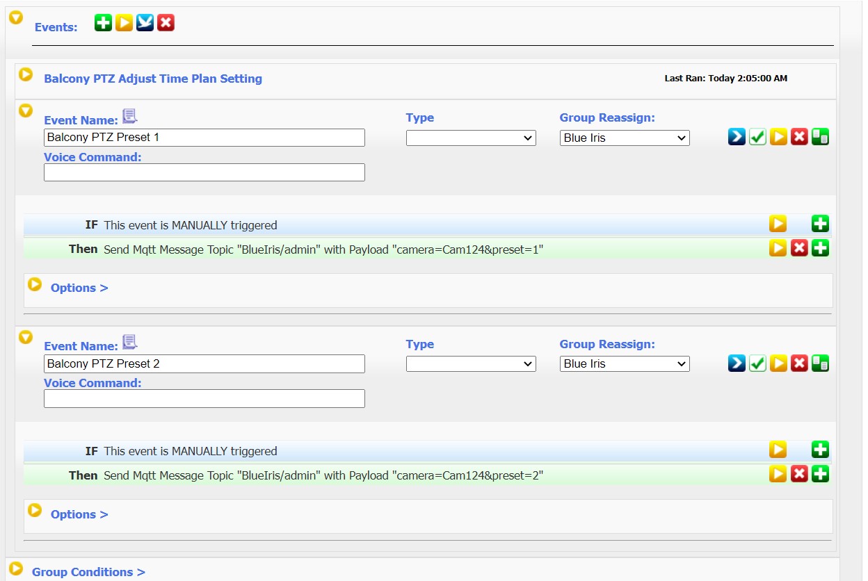

Using HS3 with free mcsMQTT plugin.
Here are a couple of events that control my balcony PTZ to preset 1 and preset 2.
I also use HomeSeer to adjust the timeplan settings for the PTZ. This is way more complicated but works well. I might start a new thread to go over that if anyone is interested.

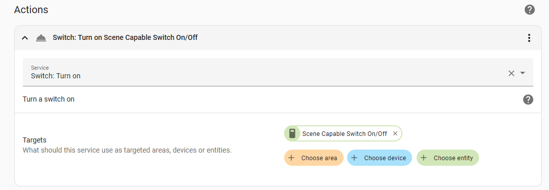

And similar to the Homeseer 3 screenshot above, Home Assistant provides something called an "Automation" which has Triggers, Conditions, and Actions.
A "Trigger" can be an MQTT message:
and then an "Action" (turn on a Z-Wave switch in this case):
It can get complicated pretty quickly if you want, with various conditions, multiple areas, devices, and entities, but hopefully this helps.

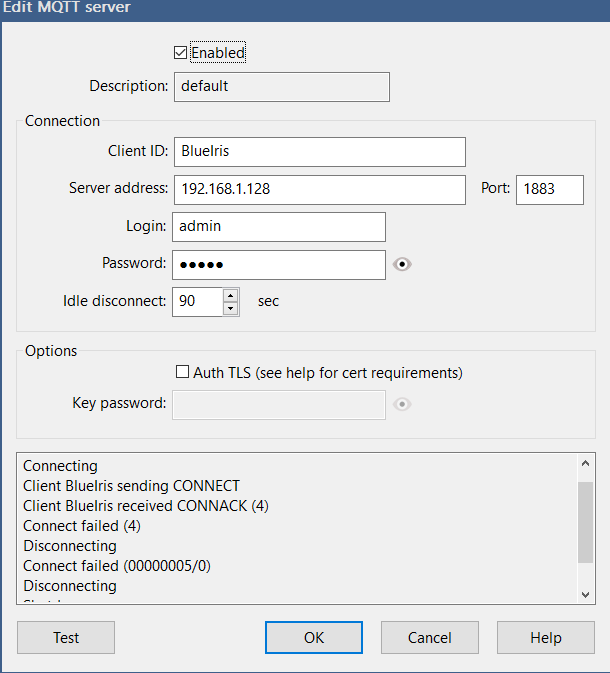

So I have my Homeseer PI device setup and working withthe mcsMQTT plugin installed. I'm having no luck however getting BlueIris to talk to it. I'm getting the following when trying to test the connection. Any ideas?

OK, well that post above was dumb..... I actually have it connecting briefly to the server now, but am seeing the following.

Post your HomeSeer msMQTT settings. I had trouble using password authentication so I left it out.

I rebooted my homeseer and the test is working now. I removed my username and password for the MQTT plugin as well.

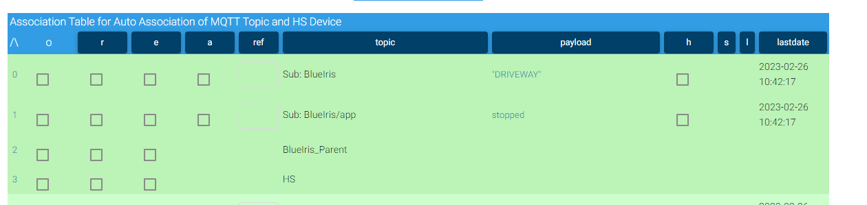

I've got the following setup and do see some sort of MQTT message, but I don't think it's what it should be....
This is my MQTT request below...
This is what I'm seeing in Homeseer

Looks like Blue Iris is sending a MQTT message successfully to HomeSeer. It is topic: BlueIris and payload: "DRIVEWAY"
That is probably not what you were looking for. You will have to adjust the BlueIris settings in MQTT and get the correct formatting etc. The user manual is your friend there. I don't have experience with this and I can't help you further.
If you want to have a Homeseer device for that topic/payload, you need to check the box under column "a" which will create the device.
