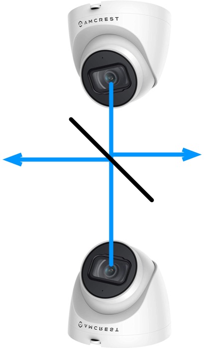

They're the exact same model, Amcrest IP5M-T1179EW-28MM, but they're mounted like this:
That's the view from where the coyotes are. Heres the closeup:
With that vertical gap between them, aligned to match up on a object 6-8' away, the parallax at any other distance is going to be significant, which is why the top of the combined image is so far off.
But this has me woolgathering a bit. The top-down view shows that the yaw angle between them is very roughly 80 degrees:
and there's a bit of a pitch angle as well.
But what if I mounted them opposing each other, e.g. straight up and straight down on that fence post, and then put a double-sided mirror, or just two thin mirrors, in the middle? Could I get optical centers of both cameras closer together that way?
I don't think well enough in 3D to be able to visualize how much freedom I'd have to adjust the angles and get the images aligned any better.

I think you'd lose way too much light fooling with a two sided mirror like that Then there's the problem of dust/dirt/moisture messing up the mirror and at the short distance between the lenses and mirror it would be very noticeable.
Another trick might be a "boobie" camera.
Boobie camera

I did think about the Boobie camera. It's a bit expensive.
For $2.89 each I might buy a couple of these mirrors and play around with the idea. I have a bunch of Amcrest bullets lying around that I won't need until swarm season starts up in ~2 months.
