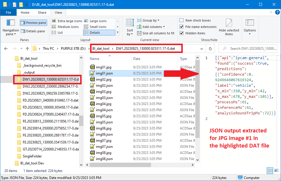

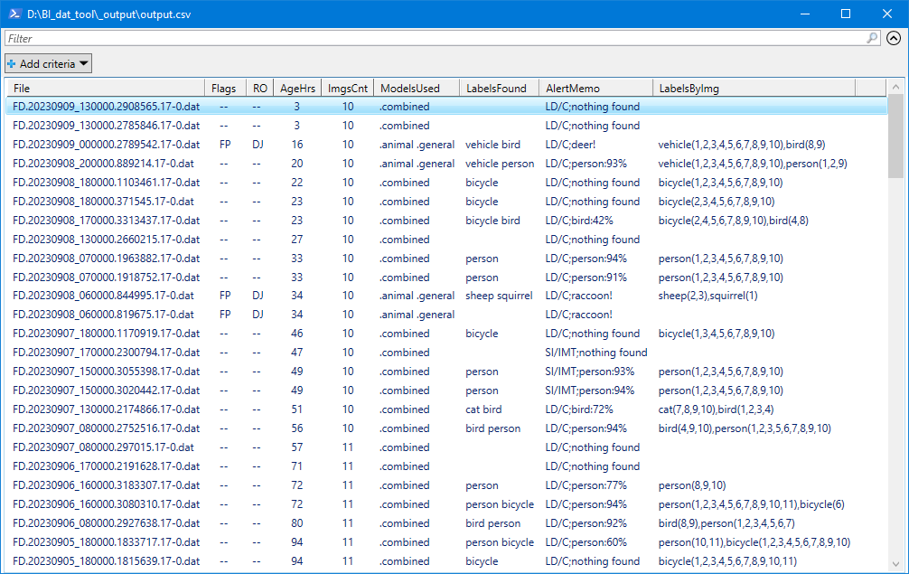

  1. Inspect DAT files showing image counts, ages, alert memos, AL models used, and AI labels found (by image)
    The results are displayed in the console, and also saved to a CSV file.

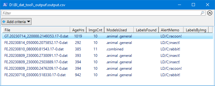

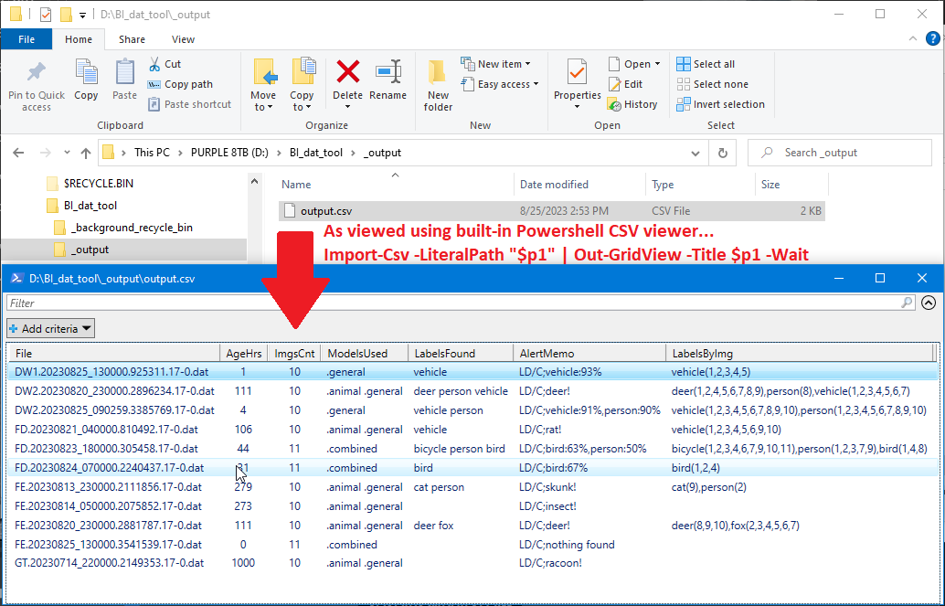

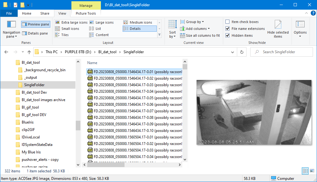

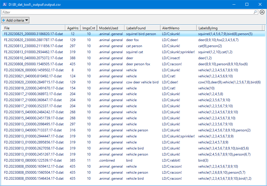

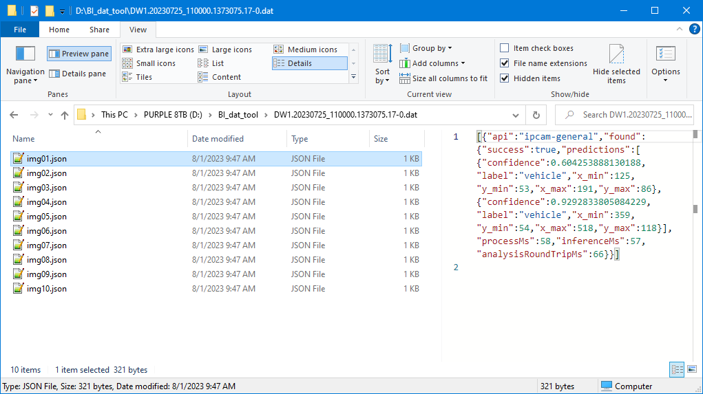

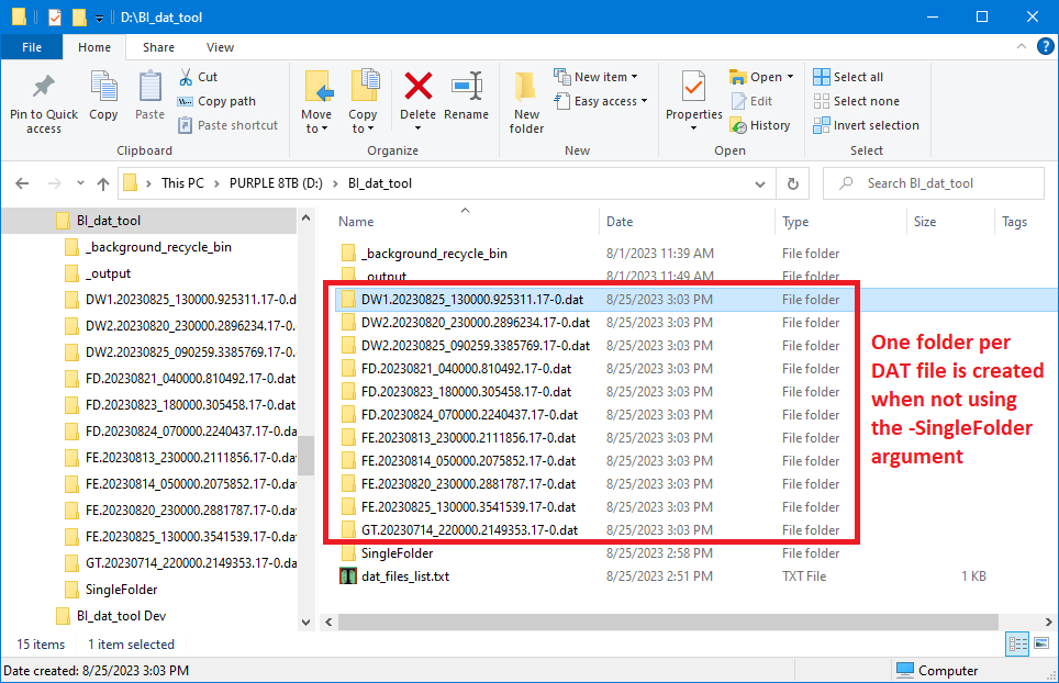

These screenshots show typical output - via the Console, or the automatically created CSV file

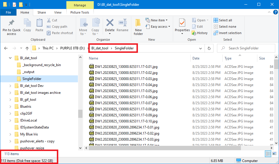

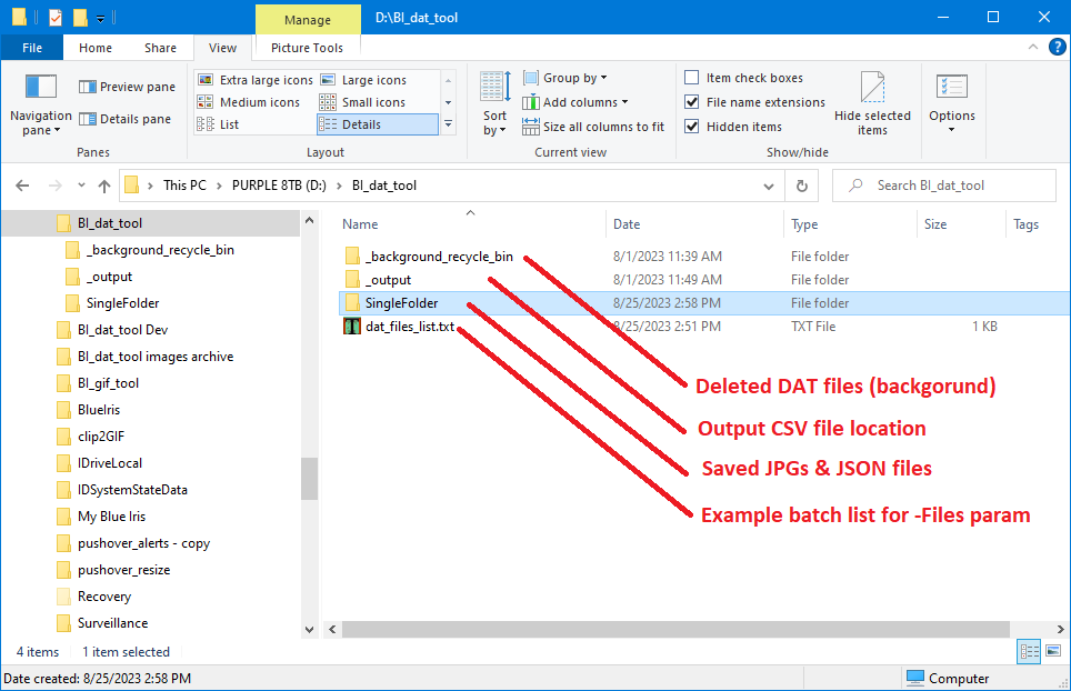

Saved JPG and JSON files are stored in a user-selected folder (specified in the user-settings file)
bi_dat_tool_folder_1.png bi_dat_tool_folder_2.png bi_dat_tool_folder_3.png bi_dat_tool_folder_5.png

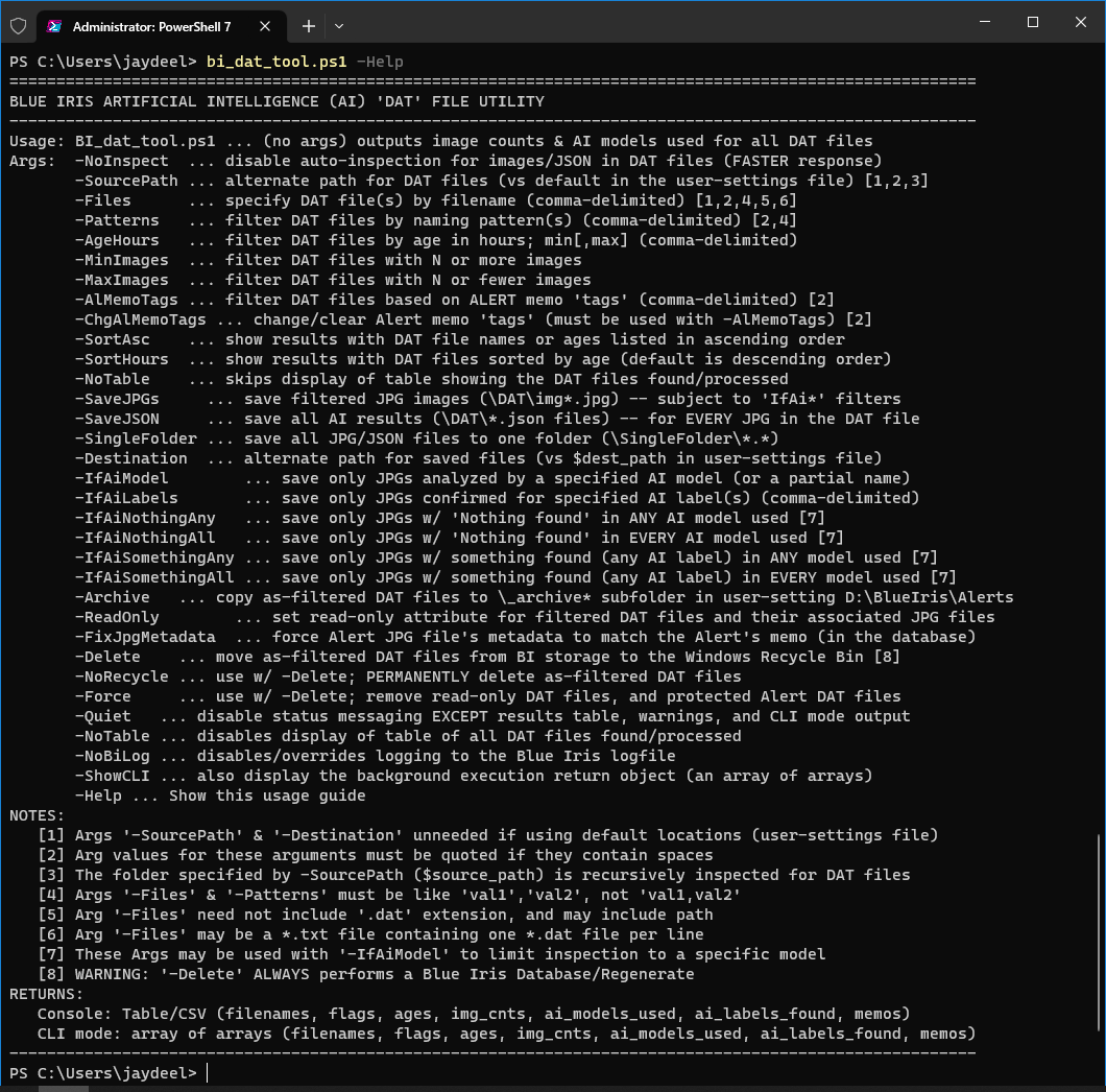

This screenshot shows the available set of commandline parameters. (EDIT: updated for v 1.2)
I will provide easier-to-consume scenario-based command examples in the next post.

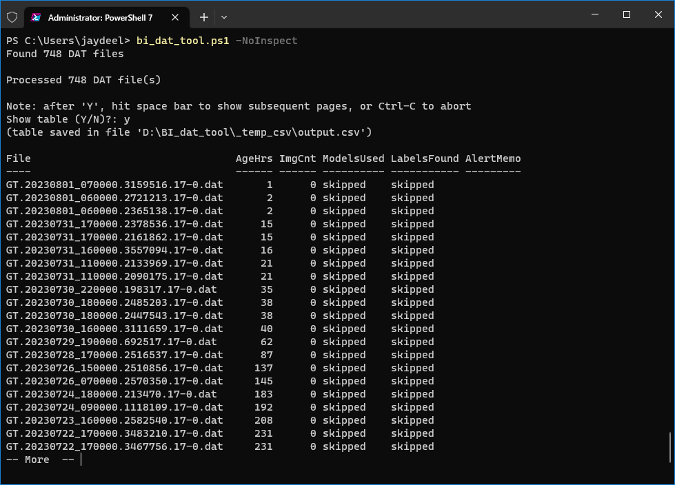

2. I want to see FAST results without waiting for the script to inspect the DAT files
bi_dat_tool.ps1 -NoInspect

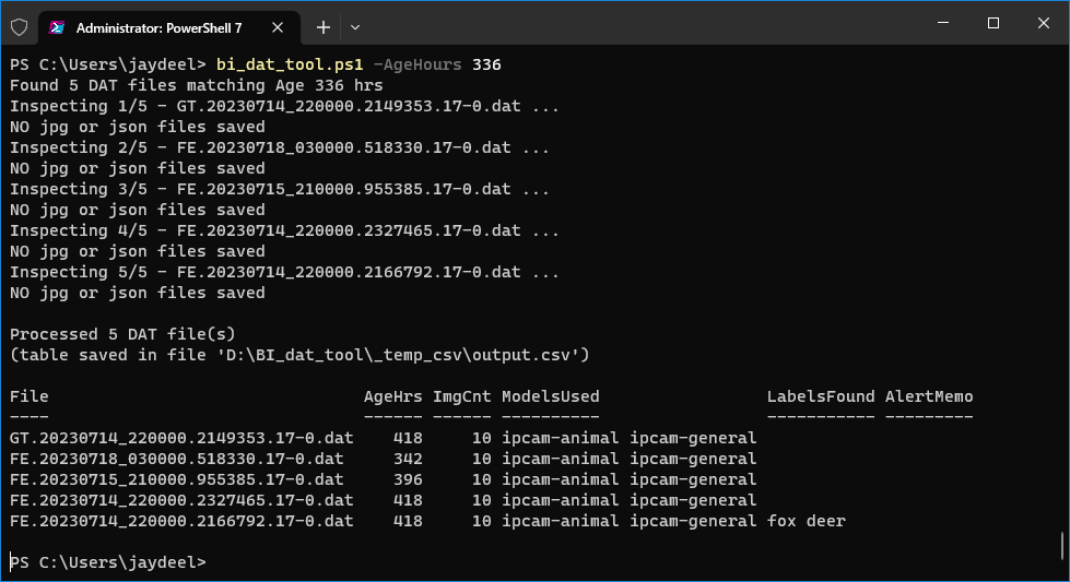

3. I want to see the total number DAT files that are older than 2 weeks
bi_dat_tool.ps1 -AgeHours 336

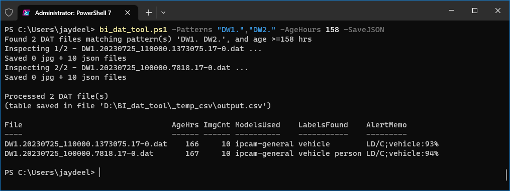

4. Before I delete DAT files that are older than 158 hours for 2 specific cameras, I want to double-check the JSON first
bi_dat_tool.ps1 -Patterns "DW1.","DW2." -AgeHours 158 -SaveJSON
Use Windows explorer to peak inside the *.json files for each image

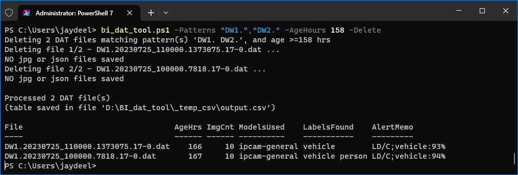

5. I want to remove Alerts folder DAT files that are older than 158 hours for 2 specific cameras
bi_dat_tool.ps1 -Patterns "DW1.","DW2." -AgeHours 158 -Delete

11. I want extract all JPGs and JSON results for a single DAT file
bi_dat_tool.ps1 -Files "DW1.20230715_150000.3251912.17-0.dat" -SaveJPGs -SaveJSON
12. I want extract all JPGs and JSON results for several DAT files
bi_dat_tool.ps1 -Files "DW1.20230715_150000.386323.17-0.dat","DW1.20230715_150000.386323.17-0.dat" -SaveJPGs -SaveJSON
13. I want to extract JPGs to a SINGLE folder for all DAT files that contain 5 to 8 JPGs
bi_dat_tool.ps1 -MinImages 5 -MaxImages 8 -SingleFolder -SaveJPGs

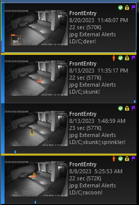

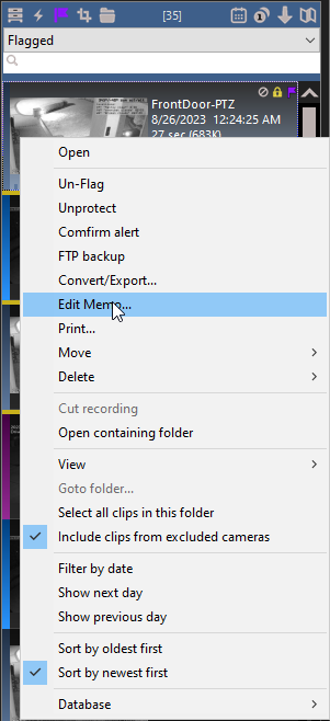

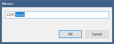

1. On a daily basis, I use the following strategy to flag alerts whose DAT files I may want to 'mine' for images for incorporation to an AI model.
Strategy: I flag & protect the alert, then manually edit the memo and assign it a label followed by an exclamation point (like 'skunk!')
WHY? The unique exclamation point character makes it easy to locate the DAT files I plan to 'mine' for JPG images.​
This results in alert entries like these...​

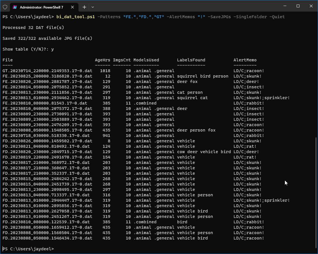

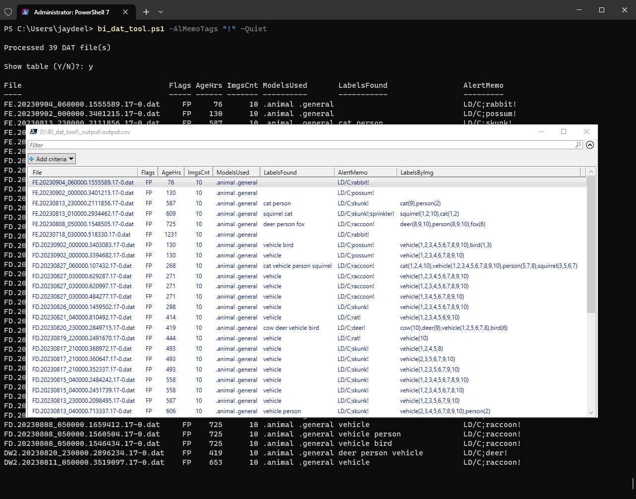

2. To mine the DAT JPG files from these ‘memo-flagged’ Alerts, I use the Powershell script as follows:
All candidate DAT files
example command:​
bi_dat_tool.ps1 -Patterns "FE.","FD.","GT" -AlertMemos "!" -SaveJPGs -SingleFolder -Quiet
Note the use of the argument -AlertMemos
This is how I use the exclamation point character to filter the DAT files I want

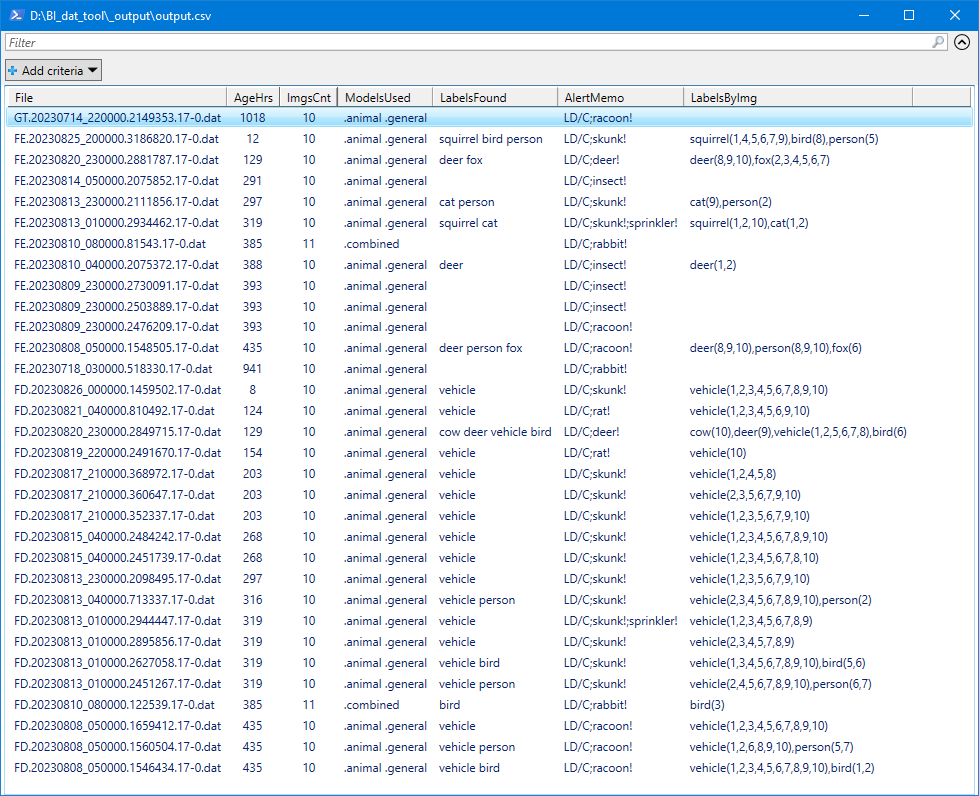

Example Output:​
example_user_edited_memos #1 console.png example_user_edited_memos #2 csv.png example_user_edited_memos #3 explorer.png

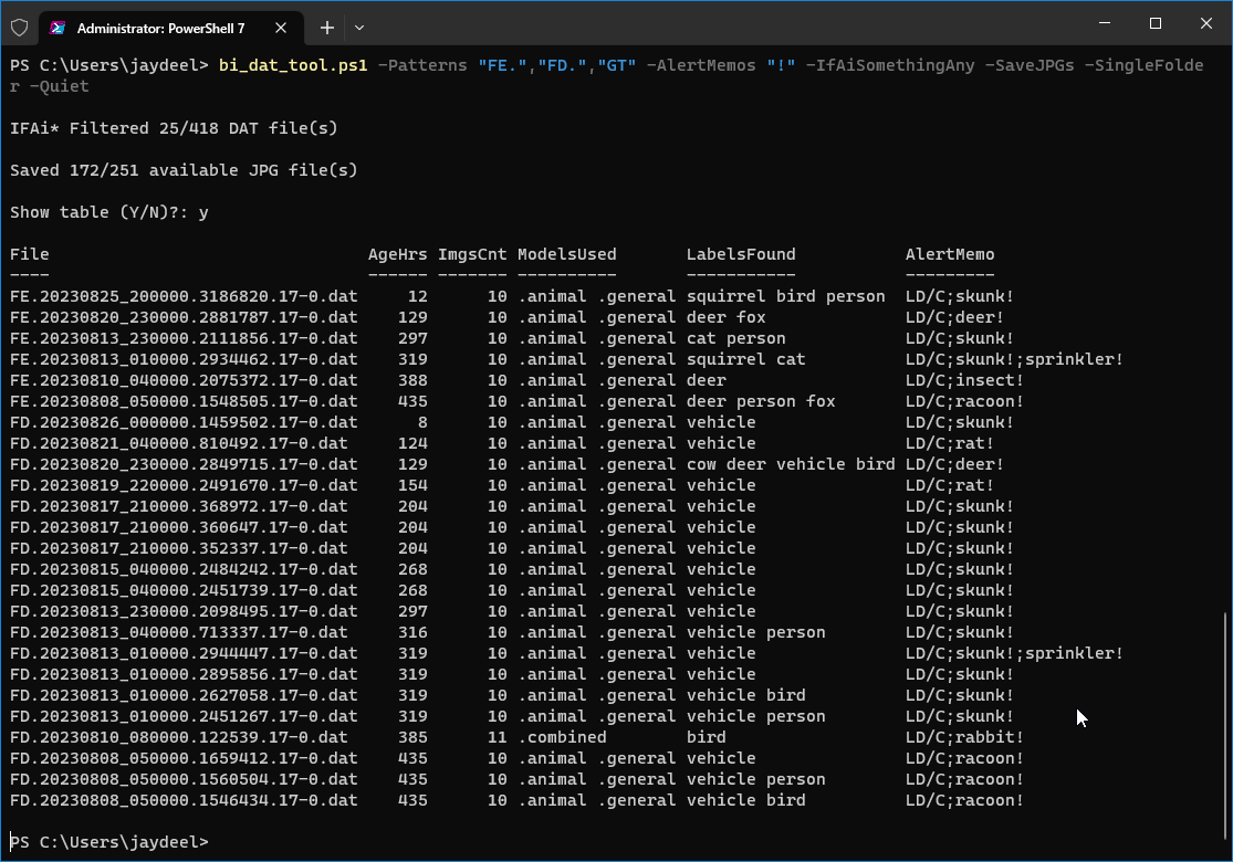

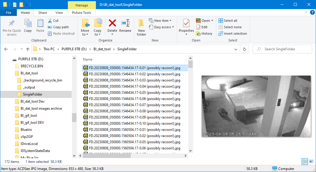

3. To refine the JPG image extraction for false positives and false negatives, I use the script as follows
3A. False positive DAT files
example command:​
bi_dat_tool.ps1 -Patterns "FE.","FD.","GT" -AlertMemos "!" -IfAiSomethingAny -SaveJPGs -SingleFolder -Quiet
Note the addition of the argument -IfAiSomethingAny
This is how I isolate the false positive images
Example Output:​
example_false_positives #1 console.png example_false_positives #2 csv.png example_false_positives #3 explorer.png

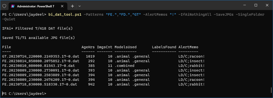

3B. False negative DAT files
example command:​
bi_dat_tool.ps1 -Patterns "FE.","FD.","GT" -AlertMemos "!" -IfAiNothingAll -SaveJPGs -SingleFolder -Quiet
Note the addition of the argument -IfAiNothingAll
This is how I isolate the false negative images

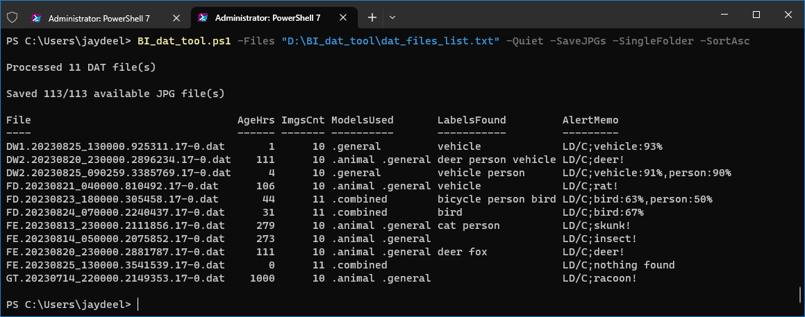

Example Output:​
example_false_negatives #1 console.png example_false_negatives #2 csv.png example_false_negatives #3 explorer.png
OBSERVATIONS / TAKE-AWAYS:

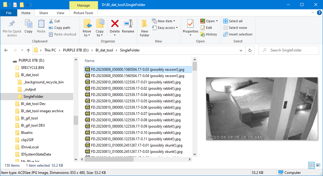

  1. In the Windows Explorer screenshots above (3rd thumbnail), note that the names of JPG files include:
    the DAT filename, the image number, and useful AI label info.
  2. Note that the total count of DAT files filtered in Steps #3A and #3B (25 & 7), match the total number of DAT files in #2 (32).
  3. Note in Step #2 that the number of JPG images saved is 322 from 32 DAT files.
  4. Using images extracted from DAT files is an efficient way to generate a lot of candidate AI model images for your specific fields of view and conditions (day/night, sunny/cloudy, etc.)

I like the strategy of adding a ! to the memo of alerts to be processed. Jw, could the script automatically remove the ! once it's finished?
Good idea. I'll add an argument that does this.

Any idea why editing the memo in BI to add a "!" isn't working? It shows up in BI properly, but when I scan the DAT files with your tool it doesn't show up. Also, Windows also doesn't the change the "Date Modified" of the DAT file, so I'm guessing the change isn't saving properly? I tried unflagging/unprotecting the alert first without success. Do I need to run maintenance on the Database or something?
There seems to be something (Edit an existing memo?) about once the DAT file is created you can't actually change the memo?
Ty
jaydeel
Nov 9, 2016
1,133
1,242
SF Bay Area
I’m sorry you are having difficulty with the script.
The script is directly importing the alert memos from the Blue Iris database via the JSON interface alertlist command.
I would first try to do a database Compact/Repair, and if that doesn’t work, so a Repair/Regenerate.
It may be possible that the script is failing to correctly build a lookup array that associates alert memos to DAT filenames. But I’m testing the script a lot the past week, and haven’t observed such a failure.
I would not assume that editing the alert memo would result in a timestamp change on the DAT file. The memo is an entry in the database.
In my experience this is not the case with the current version of Blue Iris. The past few days I’ve been editing the memos of existing alerts via the JSON interface update command (via a previously undocumented memo parameter, which Ken told me about this week). This is working whether or not the alert has a DAT file.
BTW, I’m very close to releasing an update that will add memo editing to the script.

The script is directly importing the alert memos from the Blue Iris database via the JSON interface ‘alertlist’ command.
Ah, ok, I was trying to use it on local copies of the DAT files on my computer, while giving it webserver access via VPN. I was probably screwing something up in the process.
In my experience this is not the case with the current version of Blue Iris. The past few days I’ve been editing the memos of existing alerts using the JSON interface ‘update’ command (via a previously undocumented ‘memo’ parameter, which Ken told me about this week). This works whether or not the alert has a DAT file.
Very cool, can't wait! Thank you!

Script updated to V1.1. see post #1.
Changelog:
  1. NEW: added new argument -ChgAlMemoTags to change/clear Alert memo tag characters (like "!")
  2. NEW: added new 'Flags' column to output to show if the associated Alert is 'flagged' or 'protected' in the BI database
  3. NEW: added new user-settings to automatically open the output CSV file in a Powershell utility UI (Out-GridView cmdlet)
  4. NEW: added new argument -Archive to copy filtered DAT files to \_archive* subfolder in script's destination folder
  5. CHANGE: replaced argument -AlertMemos with -AlMemoTags (-AlertMemos remains supported)
  6. CHANGE: in the output, non-existent DAT files now assigned 'AgeHrs' and 'ImgsCnt' column values of -1 (previously 0)
  7. CHANGE: in the output, -NoInspect DAT files now assigne 'ImgsCnt' column values of -1 (previously 0)
  8. IMPROVEMENT: script now recognizes unedited BI webserver address & credentials in the user-settings file
  9. IMPROVEMENT: more efficient JSON 'alertlist' GET when using arg -AlMemoTags (uses 'search' parameter)
  10. DISABLED: argument -Delete has been disabled until Blue Iris provides a safe method to delete DAT files
Item #3 shows the console's output in a nice built-in Powershell CSV viewer (Out-GridView cmdlet), which also supports column filtering.

Hi, so I'm playing around with this trying to find the right command before automating. It's scanning everything properly and I'm getting the hang of it lol.
One issue, Alert Memos don't seem to work with cancelled alerts? Whether the BI alert memo is "nothing found," or "occupied," or even a postive "To Cancel" label (i.e. "Dog:86%"), the "Alert Memo" field is blank after the tool scans the DAT file. (Labels Found scans properly though.)
Is that correct/intended? Jw, in case the AI misses something and I want to process the cancelled alert. I see a couple of -IfAiNothing arguments, but can't seem to get them to filter/search correctly. (I think it's the -AlMemoTag "!" that's filtering everything out"
Worth mentioning, -ChgAlMemoTags "" (thank you!) also requires Admin...took me a few attempts before I figured that one out lol. Makes sense, but without it the process just hung until interrupted so it was hard to diagnose.
Thank you for the tool!

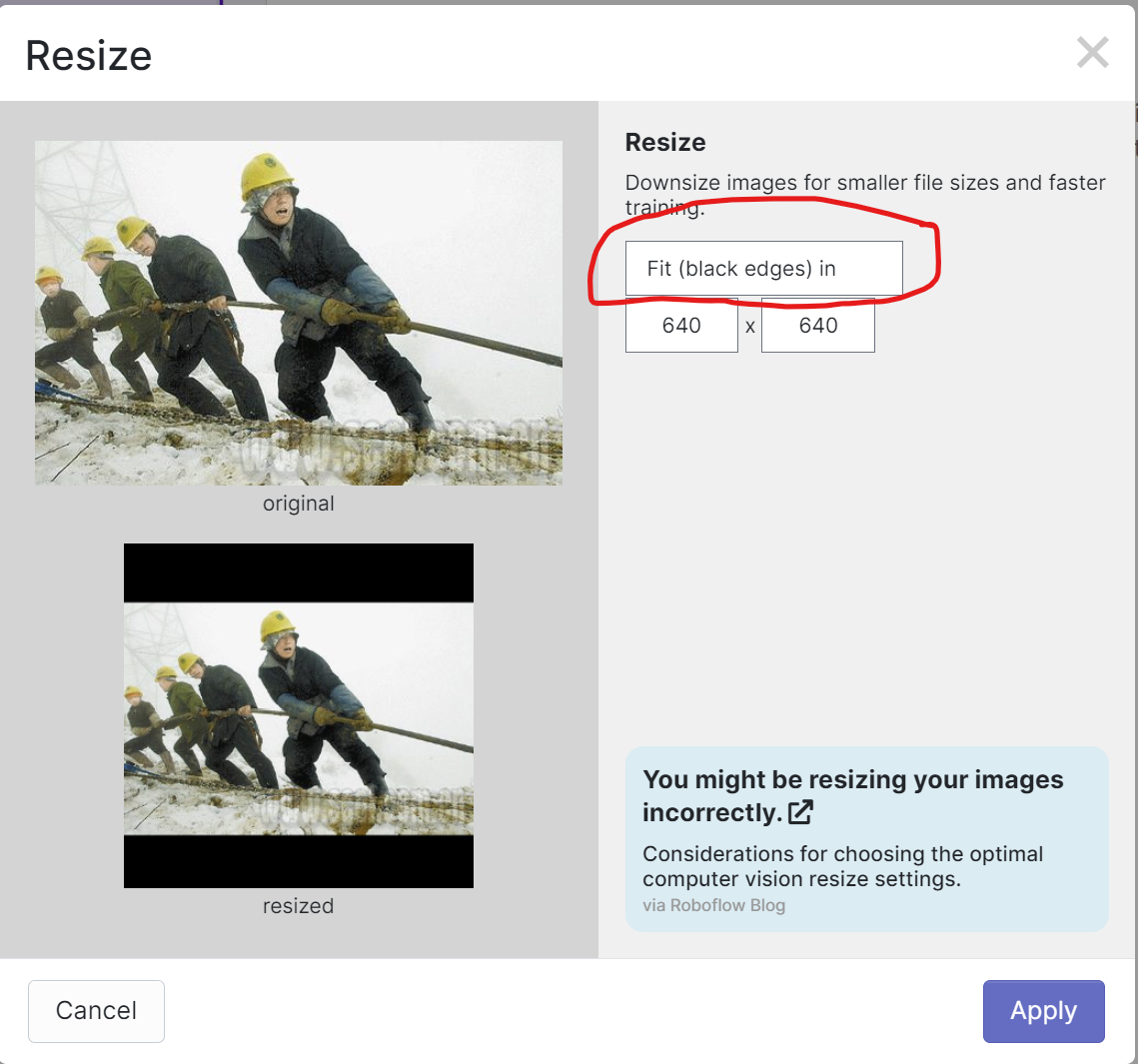

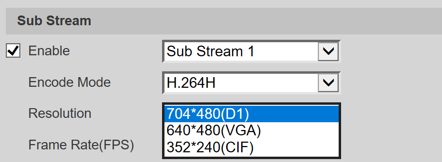

Side note: Damn, after roboflowing so many hi-res camera images, it's hard for my OCD to handle working with the sub-stream-AI processed images. o_O (Even though I know the first thing Roboflow does is "stretch" them down to 640x640 upon processing.) I might have to waste the processing power and switch the AI to "use main stream when available" for a bit. (Then my OCD will really stress about training after actually streching from 480px to 640px lol)
MikeLud1
Apr 5, 2017
2,214
4,253
Brooklyn, NY
Use ether D1 or VGA for your Sub Stream. When training it does not stretch 480px it fills the rest of the image with the color gray
A couple of points:
  • Arguments -AlertMemos and -AlMemoTags are identical and can be used interchangeably.
  • Arguments -AlertMemos and -AlMemoTags are 'DAT filters'. That is, if used, the script will only output results for those DAT files where the associated Blue Iris alert's database memo matches the specified substring (e.g., '!') anywhere in the alert's memo.
  • 'IfAi' arguments like -IfAiNothingAny and -IfAiNothingAny are 'JPG filters'. When used they restrict which JPGs are extracted. They do this by looking at the AI labels the JPGs do, or do not, contain... I understand that this can initially seem very complicated (even more so to code!). Please re-read the 'false positives' and 'false negatives' script command examples in post #3; note how they are used to control which JPGs are extracted. Hope this eventually makes sense, lol.
If you do not use the the -AlertMemos and -AlMemoTags arguments, the output should show results for 'nothing found', etc.
For example...
EDIT: BTW, the screenshot above is from version 1.2 (still in process). It adds a column ('RO') showing if the specified DAT file and its associated alert JPG (if it exists) have their Windows 'read-only' file attributes set... Per Ken at Blue Iris support, so-called 'protected' alerts (as marked in the database) will be certain to survive a Database/Regenerate action only if one these files have the read-only attribute set (next version of Blue Iris). So knowing if the read-only attributes are set will be a key piece of information if you are trying to protect special alerts.
Thanks for the heads up.
In version 1.2, I'll 1) try to trap this condition, and 2) mention this more explicitly in the user-settings file.

Sorry, I'm just able to get back to this and take a real look...
  • If you do not use the the -AlertMemos and -AlMemoTags arguments, the output should show results for 'nothing found', etc.
Ok, I was just trying to filter/process a cancelled alert by adding an explanation point to the alert memo (i.e. "nothing found!") (when the AI misses something entirely) and it wasn't processed. I think because the tool ignores (or can't read) the database alert memos of cancelled alerts? (Or I'm just missing something.) If possible, could you add that feature?
  • 'IfAi' arguments like -IfAiNothingAny and -IfAiNothingAny are 'JPG filters'. When used they restrict which JPGs are extracted. They do this by looking at the AI labels the JPGs do, or do not, contain... I understand that this can initially seem very complicated (even more so to code!). Please re-read the 'false positives' and 'false negatives' script command examples in post 3; note how they are used to control which JPGs are extracted. Hope this eventually makes sense, lol.
Yeah, those arguments are super confusing lol. I think I eventually got them though...
  • For a POSITIVE alert, ifAiNothingAny extracts all the "other images" sumitted to the AI where nothing was found, before/after an object was successfully detected?
  • For a POSITIVE alert, ifAISomethingAny extracts images where an object was detected but was different/incorrect from the final AI label after the analysis ended?
lol the examples were a bit more confusing because I didn't understand the -Patterns "FE.","FD.","GT" argument. I think they are your camera names lol?
Suggestion for 1.2: Can you make -SingleFolder an argument that obeys the user set destination path, rather than a folder named SingleFolder? Basically I'd like to extract directly into the destination Images folder. I thought about updating it in the script, but then I would have to remember to change it with every update lol
Thank you
