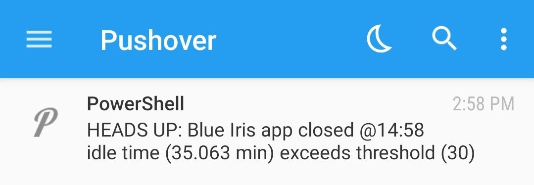

1. [Optional] Editing a PowerShell script to configure your custom idle time. And Pushover settings if you want to receive notifications, like this

2. Also opt in to sending Pushover notifications.

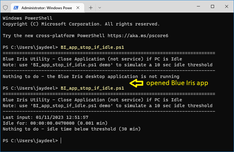

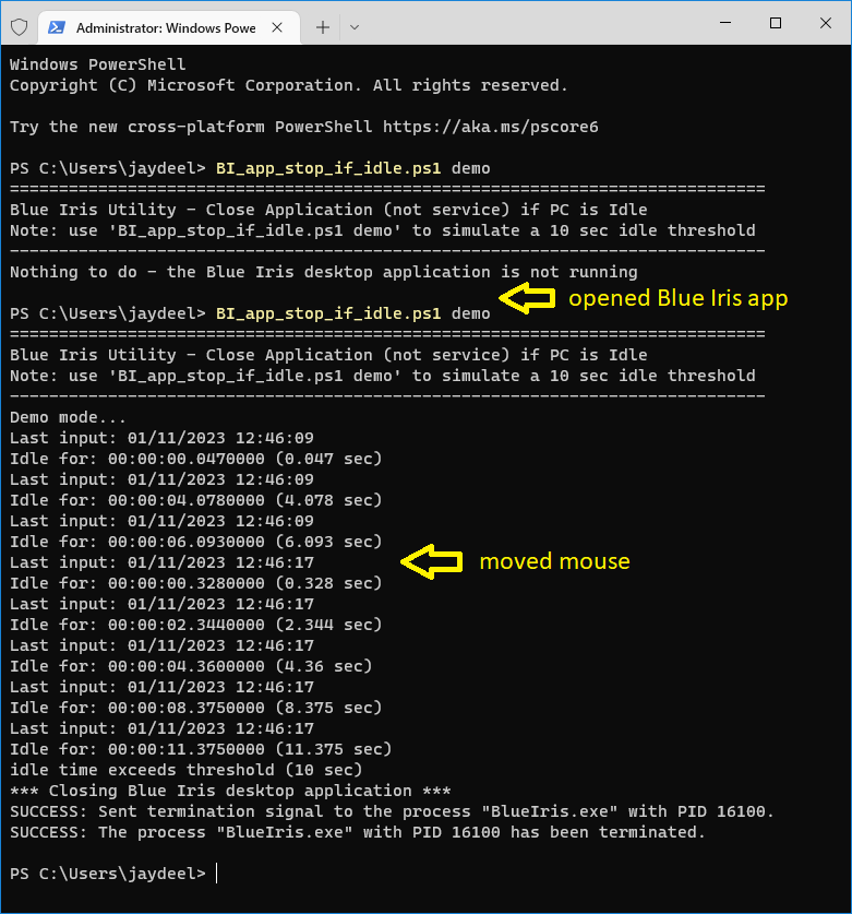

The following screenshots illustrate the script's output (in a PowerShell window).
1. Usage in 'demo' mode.
2. Usage in normal mode.
