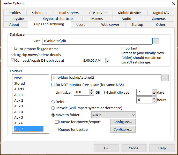

ok, not currently recording, cameras moved to another house..
can u enlighten me on the "you didnt set it up properly"

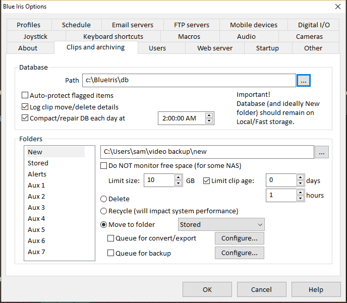

new (to stored every hour, works, has no files, currently not recording)

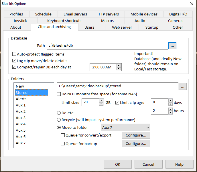

stored (to aux7 every day)
has files
aux7 (to aux6 very 7 days)
has files

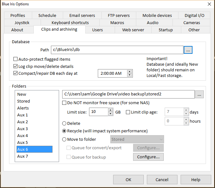

aux6 (do nothing..)

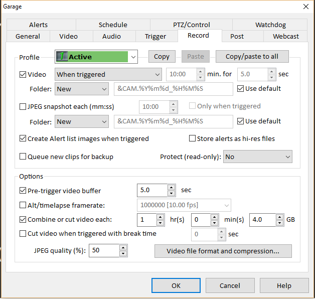

fenderman
Mar 9, 2014
36,908
21,297
Are you using combine and cut? if so what settings? It will also not likely work on older files...i have not tested that...

FlipNJ
May 3, 2016
353
128
Blue iris has this built in...clips and archiving...moving it manually corrupts the database...
Hey man. Where do I even start to.... automatically have BI export the last (most current) 3 days of clips to either onedrive or dropbox. I cant seem to find out a starting place. TIA! BTW I did read the help but Im still too dense to get the concept. My problem was I updated to latest version and doing so changed each of my cameras settings and UNCHECKED the box for "create alert image.." under Record tab.
