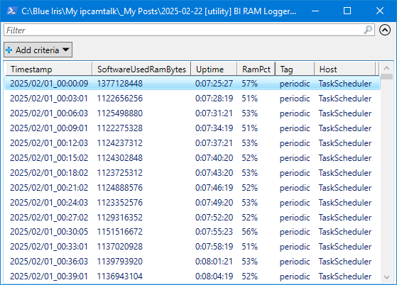

The script's output is a CSV log file with the following columns:
  • Timestamp
  • SoftwareUsedRamBytes - the memory used by the Blue Iris process
  • Uptime - the uptime for the Blue Iris process
  • RamPct - the memory used by the system
  • Tag - used to identify background, console and simulation-created entries
  • Host - used to identify the Windows process that called the script
If you are curious, this screenshot shows the CSV file as viewed by the Powershell Out-GridView cmdlet. I've previously posted about this and other lightweight CSV viewers. Of course, you can always simply open & inspect CSV files a text/code editor (like NotePad++). In some cases this can be preferable when you are searching for specific date pattern or events.

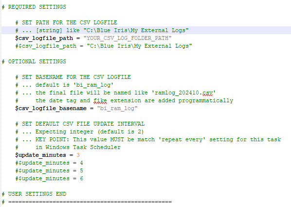

STEP #2:
Edit the user settings file
The user settings file is named 'BI_ram_logger_user_settings.ps1'​
  1. Open the file in a text editor (a code text editor is recommended; I use Notepad++.
  2. Edit the REQUIRED SETTINGS section (see screenshot)
  3. Ignore the remaining settings for now. They provide customizations that you may want to explore later.

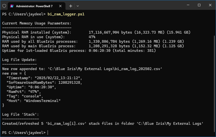

Test the script from the PowerShell console
Open an Admin PowerShell window, or Powershell-ISE window (I use Windows Terminal):​
Type the following command into the console.​
BI_ram_logger.ps1 -Current
Hit the Enter key.​
This will show the current parameters without logging the data.​
Next, remove the argument -Current​
BI_ram_logger.ps1
Hit the Enter key.​
Both responses should look like following screenshot:​

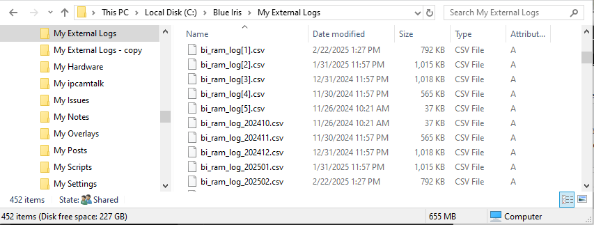

The script populates the working folder with CSV log files that are automatically rolled over every month.
Furthermore, the script automatically creates a 'stack' of the 5 most recent files, which makes it easier to use the most recent files for charting programs, etc.​

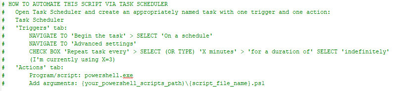

STEP #4
Automate the script from Task Scheduler.

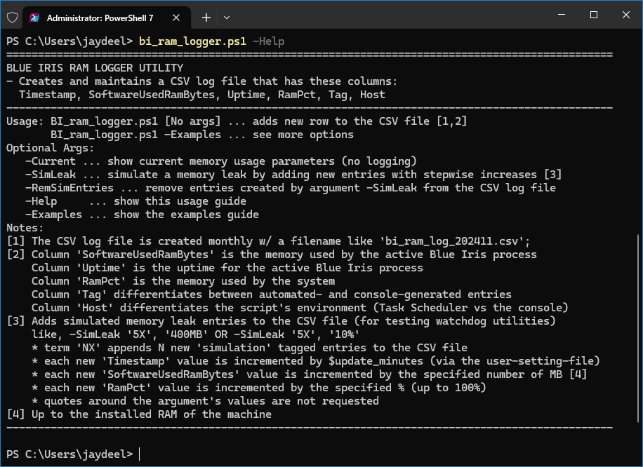

USAGE GUIDE Screenshots:

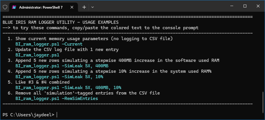

Advanced features...
The script also has two optional commands that can insert and remove fake data to simulate a memory leak event.
Why? This can be useful when testing scripts that monitor the CSV log file.
For example:
BI_ram_logger.ps1 -SimLeak 5X, 400MB will append 5 new rows simulating a stepwise 400MB increase in the software used RAM column.
BI_ram_logger.ps1 -RemSimEntries will remove all 'simulation'-tagged entries from the CSV log file.
To learn more, try
bi_ram_logger -Examples
