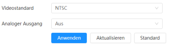

Not sure what camera that is? But typically NTSC=30fps and European PAL=25fps
It doesn’t really make much difference. Just make sure your NVR and cameras are using the same standard
