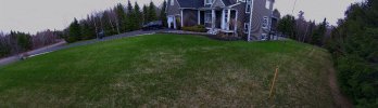

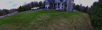

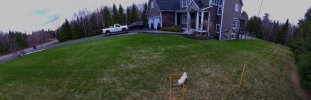

Hi everyone, first time poster, long time lurker. I have been playing with a few cameras now for months and am quite frustrated and finally reaching out to the community for some guidance. Attached are some photos of what this camera has a view of. Tonight, someone came to visit, the camera did not notice the truck pulling in. It did not send any notifications when the man was out on the walkway. It did not send any notifications when we took the garbage bin out or walked back in without it (no person detection). It finally did send a notification when the visitors dog got up to it and then also noted the vehicle. It also sent a notification when the truck backed out (but again not when it arrived). I am not sure if it is my settings or what is going on. At night, I get absolutely no notifications from this cam or another cam out back, even with the contrast and brightness changed. You can be 10 feet from it, and nadda. Any guidance or feedback would be greatly appreciated. I am running the latest version of BI and CPAI (yolov5 - I have also tried 5 6.x, and 8) I am running on a Server 2025 vm, 16GB of RAM, 8 cores over two Xeon processors.
