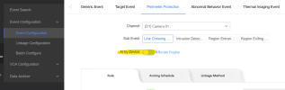

I bought a brand new ds-7616NXI-i2/P16(E). (firmware V5.04.060 build 250523) Setup the device, migrated my camera's (AcuSense, non AcuSense, AliExpress "hik-compatible" and ONVIF streams) and configured the VCA Engine as: "Perimeter Protection". This because i want to use non acusense, hik-compatible and onvif with the perimeter VCA capability.
This works fine.
But something is confusing me. When i setup regular Motion detection there is a warning message for every camera: "Not enough resource for motion detection analysis. Check the engine configuration in smart analysis."
The Engine is not configured for motion detection but for Perimeter Protection. Why is this message here then?

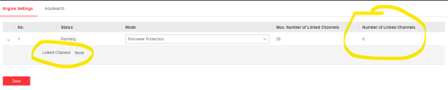

What i tried:
  • Fully unload the VCA engine (Unload option)
  • VCA engine set to "Motion detection" and cleared al the motion detection area's and disabled motion detection per camera on the NVR.
  • VCA engine set to "Motion detection" and cleared "AI by NVR" and/or "Dynamic Analysis" options per camera on the NVR.
  • VCA engine set to "Motion detection" there are NO Linked channels (devices) under the VCA.
I can click the "X" to remove the message but then next time is i present again. This happens on every camera.

I don't have any human/vehicle function enabled at the motion detection section on any camera. As shown above that is the only camera that displays that function and they are unchecked.
I don't know what you mean with "motion 2.0". I don't see that remark Anywhere can you explain it s little bit more?
The only option I have selected at the motion detection section is "dynamic analysis".
Update: i used the: "Restore to Default Settings All parameters except network parameters and user account will be cleared" setting. Configured the VCA engine to "Permeter protection", added the camera's again and instantly got that notification again. Super annoying.
