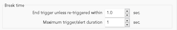

Right now I'm capturing plate numbers for vehicles on the street. It works great for the first vehicle, however, in a string of 4 or 5 vehicles it will only collect a single plate. If there is a 5 second "cool down" period then other plates will be captured as well. I have been scouring forums but can't find any help with generating more alerts.
My Zones are set up as A (full picture), B, C, and D are smaller segments of the image. When movement passes through zones BC>D it sends an alert to AI. AI analyzes zone A for plates. This has been working well and reliably captures as many as 2-3 plates per minute. But it misses about 25% of the traffic.
How do I reliably capture all movement between those zones regardless of the last trigger? I've tried extending the trigger/retrigger but it doesn't seem to do alerts correctly. Ideally it would generate an alert any time there is movement through those zones.
