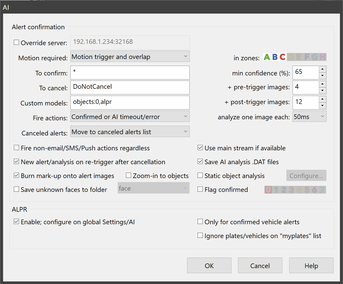

Step 4: Configure Blue Iris AI Settings
  • Open Settings: In Blue Iris, click the gear icon (top left) to open Settings, then go to the “AI” tab.
  • Enable CodeProject.AI: Check “Enabled” under “CodeProject.AI Server.” Set the server address to (or your PC’s IP if running on another machine). Test connectivity—it should say “Connected.”
  • Enable ALPR: Check the “ALPR for Plates” box (bottom left). This tells Blue Iris to use the License Plate Reader module.
  • Custom Models: Uncheck “Default Object Detection” (we’re using custom models). In the “Custom Models” field, add: license-plate. This uses the YOLOv5 model to detect plates.

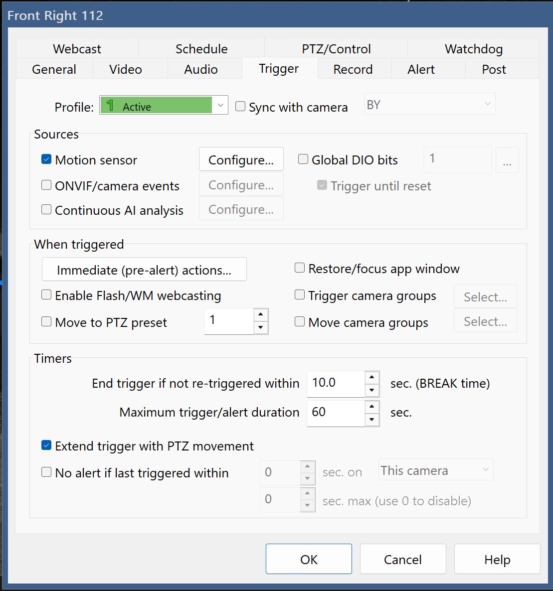

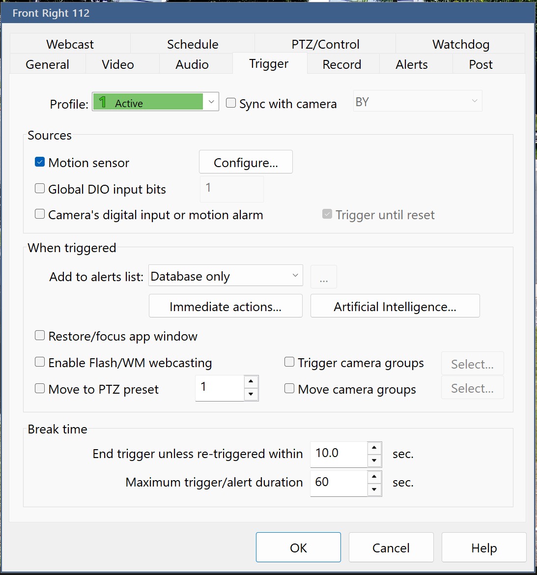

  • Camera Settings: Right-click your camera in Blue Iris, select “Camera Properties,” and go to the “Trigger” tab.
  • Motion Trigger: Enable “Motion Sensor” and configure zones to focus on where plates appear (e.g., driveway or gate). Adjust sensitivity to avoid false triggers.
  • AI Settings: Click the “AI” button in the Trigger tab:
    • To Confirm: Enter * (this ensures alerts trigger when a plate is detected and read).
    • To Cancel: Leave blank or use DoNotCancel (avoids canceling alerts unnecessarily).
    • Custom Models: Add license-plate here too (specific to this camera).
    • Burn Labels: Check “Burn label mark-up onto alert images” to see plate numbers on snapshots.

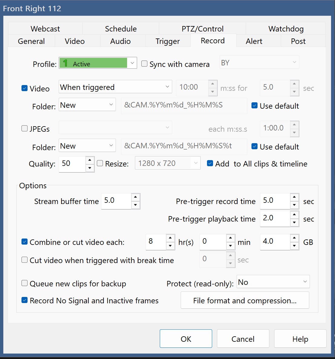

  • Alerts: Go to the “Alerts” tab, add “Hi-res JPEG files” to save plate images, and optionally set an action (e.g., email or push notification) with the &PLATE macro to include the plate number.

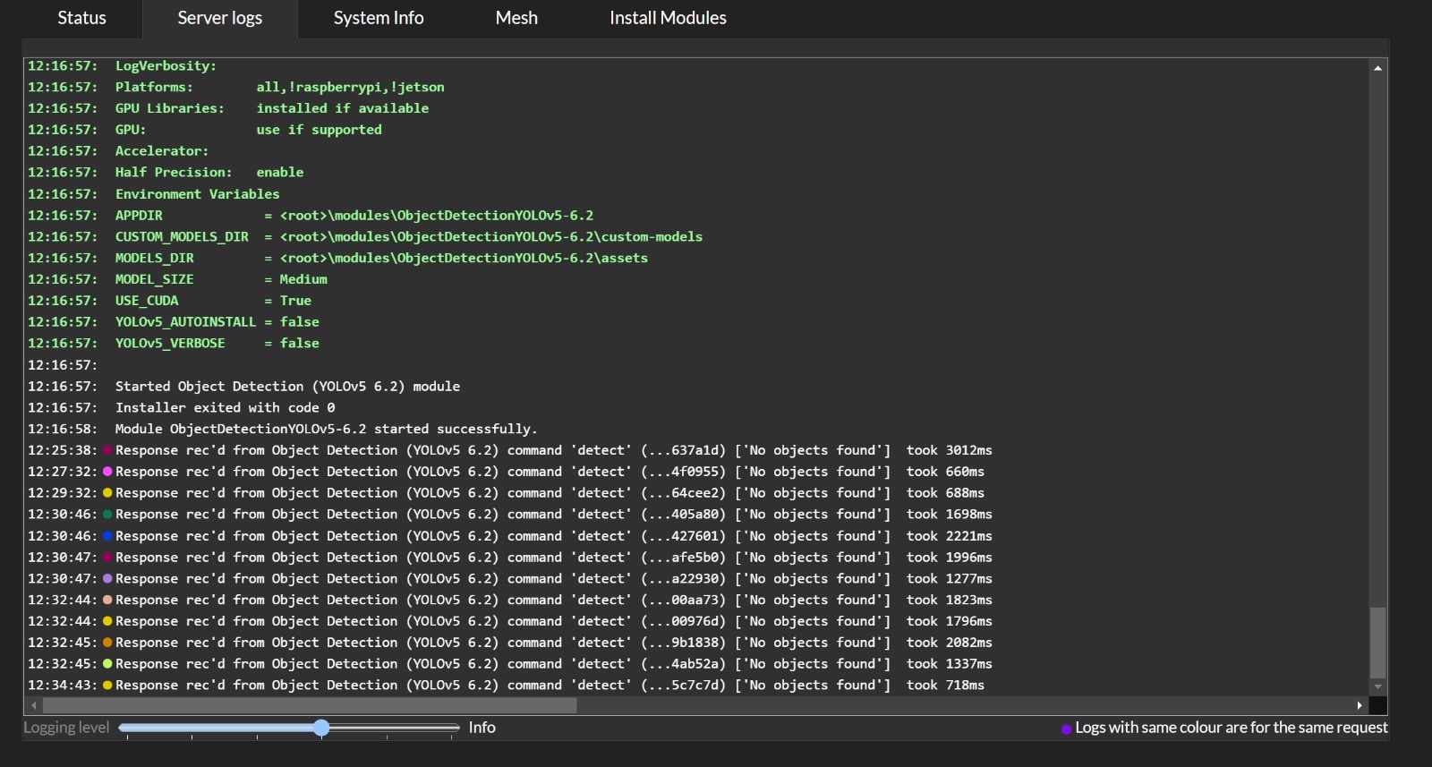

  • Test It: Drive a car past your camera or upload a plate image to CodeProject.AI’s “Explore” tab (drag and drop). Check the Blue Iris log (bottom right) for entries like “AI: Plate: ABC123 detected.”
  • Check Logs: In CodeProject.AI’s dashboard, go to “Logs” to see if plates are being processed (e.g., “Response: Plate: ABC123”). If it says “No plates found,” ensure your camera’s field of view is clear and the plate is legible (sharp focus, good lighting).

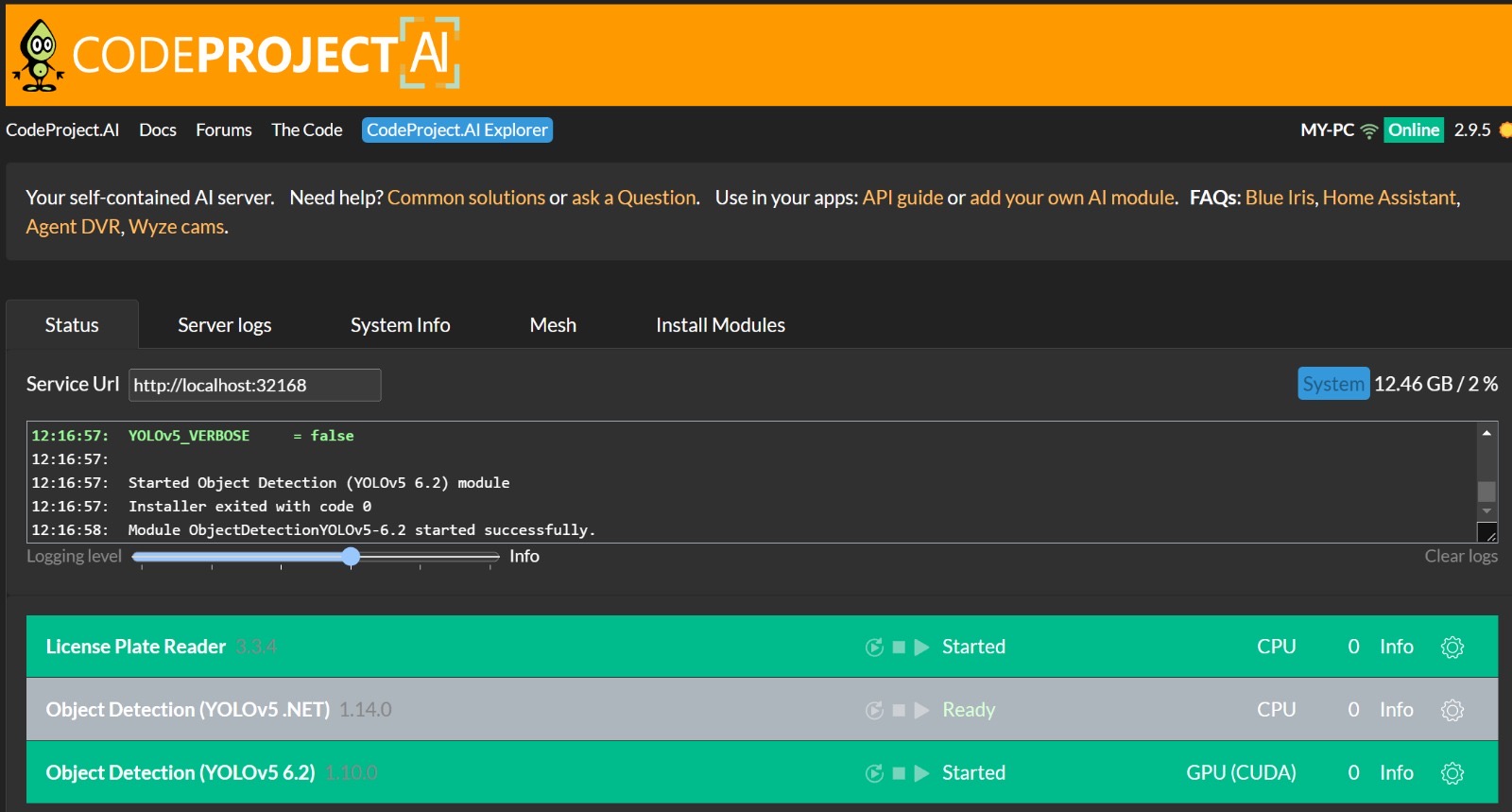

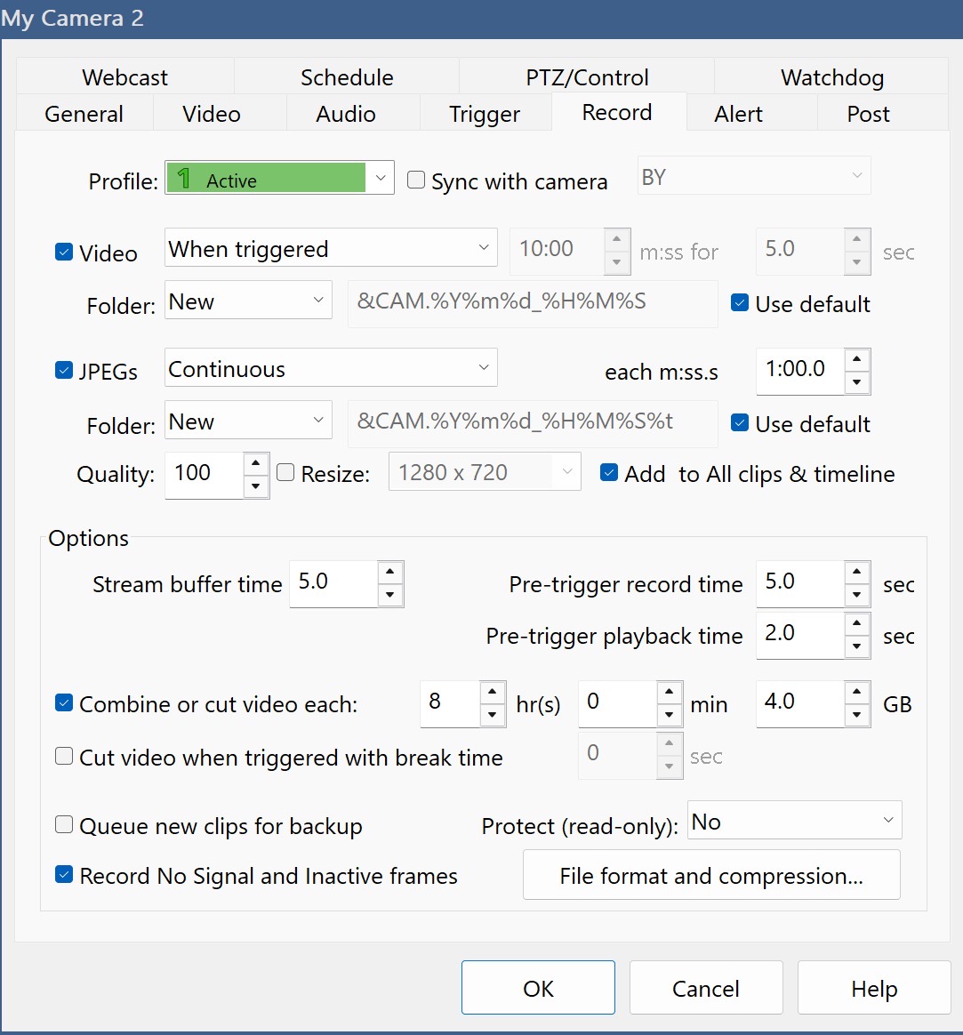

Please check what needs to change according to my attached screenshots.
I think I’m very close to getting this working. Motion detection etc also needs to be configured properly.

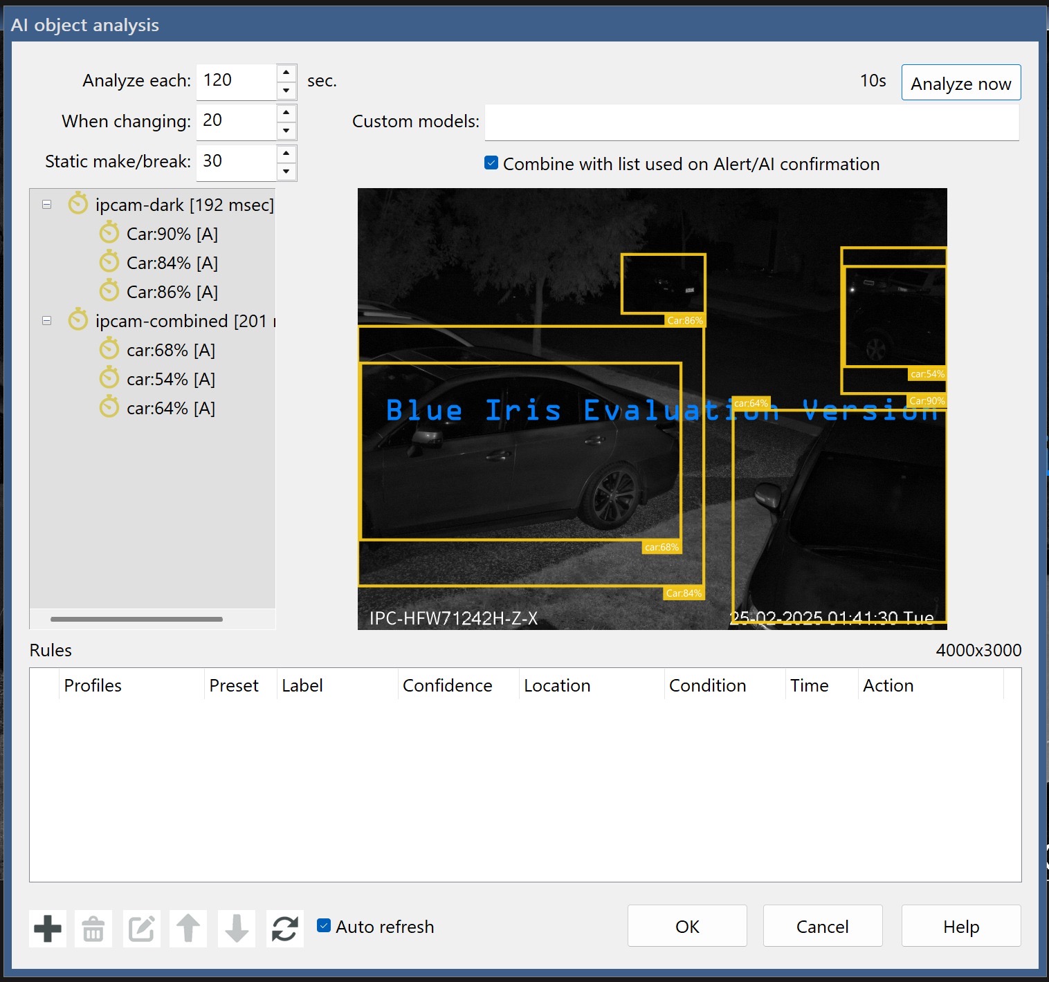

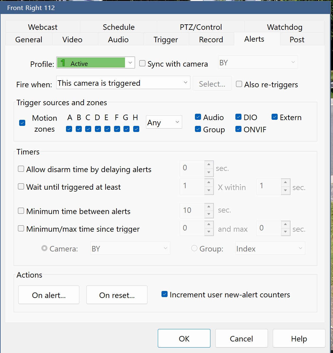

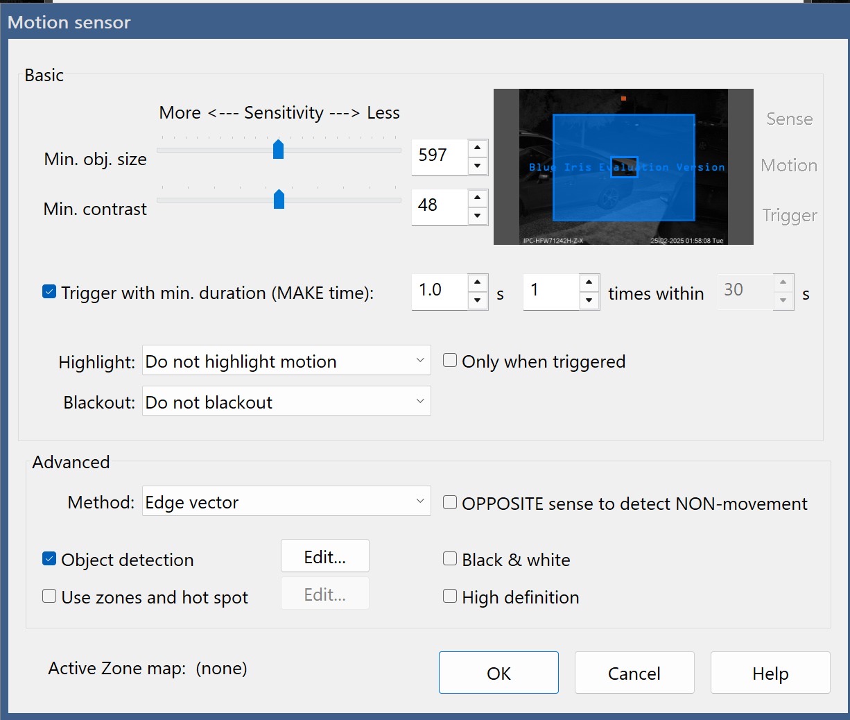

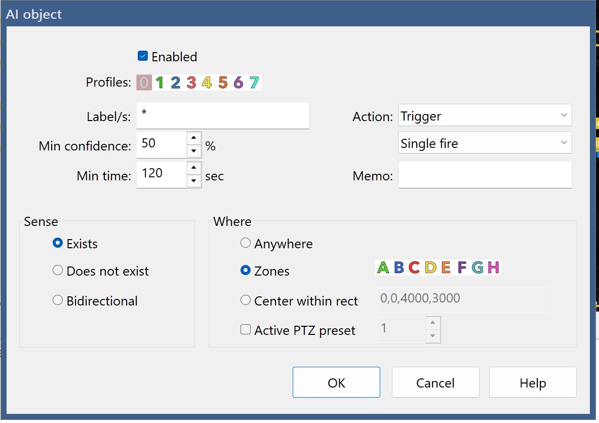

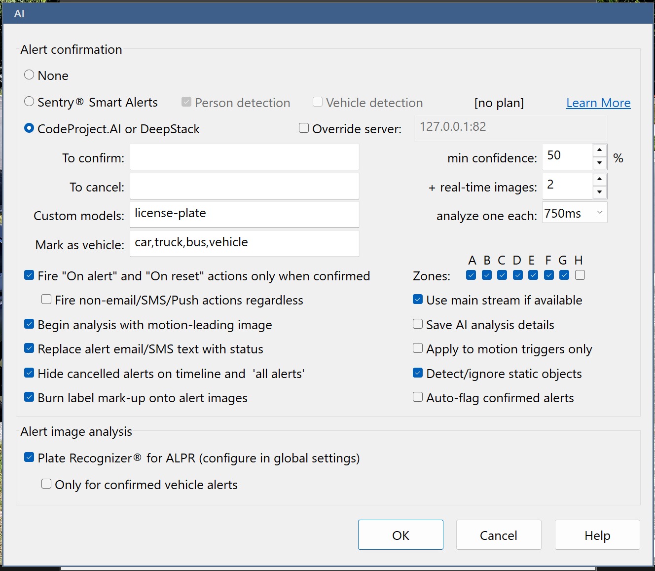

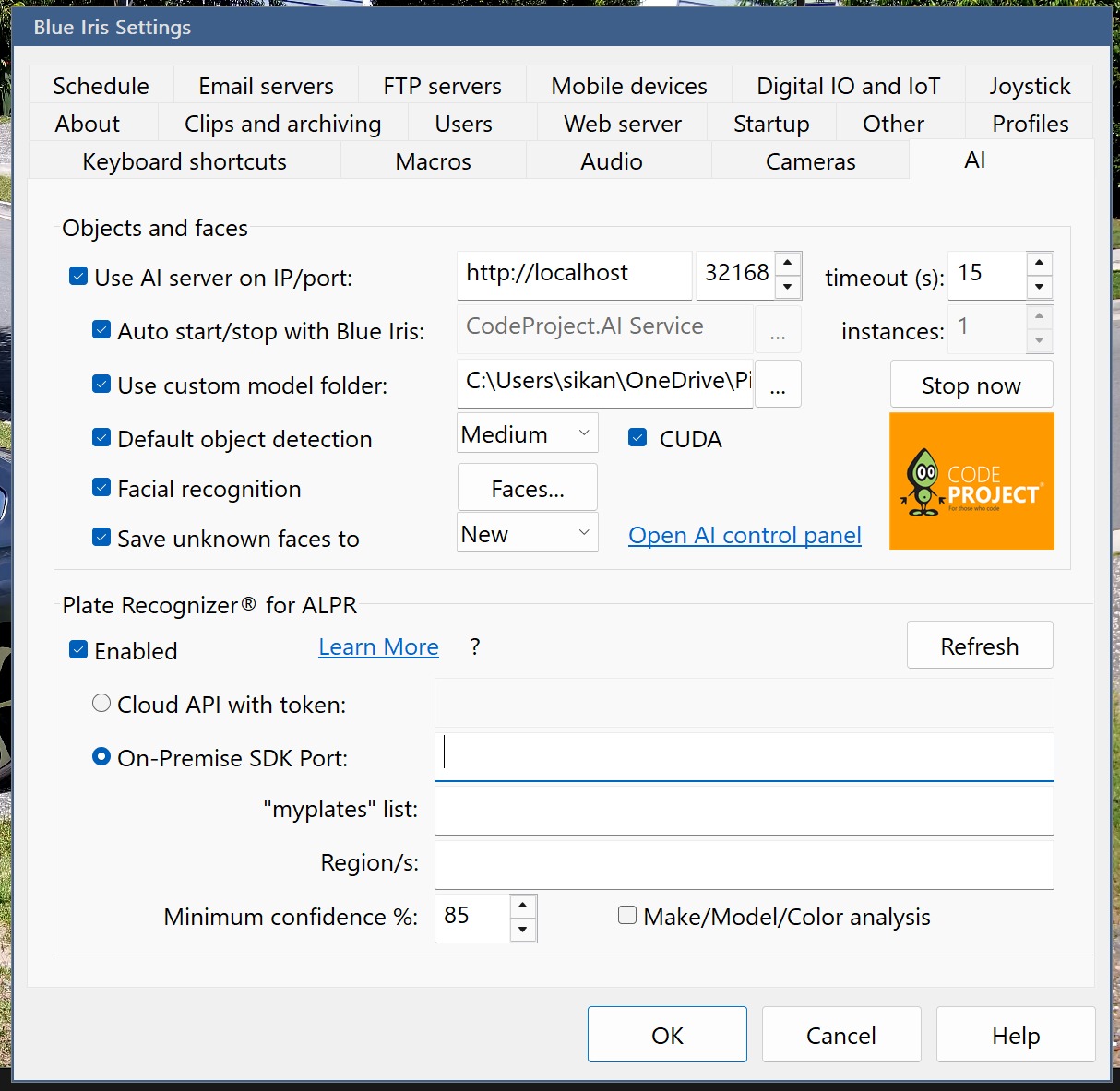

Ok, I have installed the latest version of BI. Could you please share the screenshots of all the related settings that can help me configure it properly?
Personally I think it is a lost cause - that field of view is too wide and the angle is too sharp.
You need a different camera with more optical zoom or move that camera closer - 12mm is good for typically 20ish feet or so.
But things to try and see how many you can get include:
Make the camera 1/2000 shutter and gain 50 - that shutter looks too slow to be able to make out vehicles on a 12MP camera on the 1/1.8" shutter. The image will then be completely black except for plates and headlights/tailights.
Then in BI on this page you need to make object size a lot smaller since all you will see is the plate - it needs to be about the size of a plate in your field of view.
Min contrast make it the min.
Make time should be 0.1
Uncheck the object detection box.

Another thing to do so you don't waste more time with a camera and angle that isn't suited for it.
Playback a video of a car going by and pause the image with the plate in the middle of the frame and take a snapshot.
Go to CodeProject and select the text in blue:
Then this screen pops up and choose file and select the one you just did a snapshot of. If it can't read the plate, then no sense bothering with anything else until you get more zoom and a better angle.
